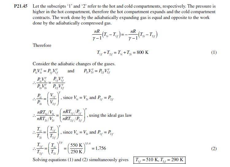

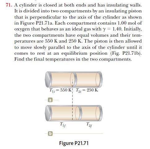

I have been struggling to find my mistake for over 2 hours now and I still haven't exactly matched my answers with the books solution. I feel that my method should give the same answer the solution manual obtained however they are slightly off.
I understand the book method completely.
Can someone tell me why my method doesn't work or find a way to make it work. I won't be able to sleep until I know.
Thanks
Book Question:
Book Solution:
