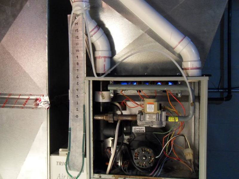

I did a quick knock up of this.
I'm measuring the gas pressure on my furnace.
Is there anything immediately wrong with the manometer as you can see it in the image?
There is a valve at the bottom that is no obstruction to the flow. It's there only to drain the manometer for easily zeroing the fluid.
I assumed that inches of water was almost foolproof.
The furnace specs measure gas pressure in w.c.
Pressure on the output side of the regulator is spec'd at 3.5" w.c. with the furnace running.
Gas pressure from the household supply side is spec'd at 7" w.c. with the furnace running.
My manometer measures the output at 1.75 and the supply at 2.95.
These numbers are highly suspicious since the furnace ought to be pretty close to 3.5 w.c. (I was only checking) and the household supply comes directly from the meter with no other valves or obstructions in the pipe and should definitely be close to the standard 7" w.c.
So I suspect that my manometer is off by some magnitude. How can that be? Inches of water is inches of water. It's damn basic stuff. No?
Assuming one side of the manometer is open to the air, you measure the difference in heights of the two columns, not the change from the zero position. So the picture shows a reading of about 3.5 in, not 1.75 in.
So while the weight of most other oils and fluids at hand to fill a manometer are generally equal, are the differences in weight between them appreciable enough to care about in my homemade manometer? Water, hydraulic fluid, light motor oil, etc?
The specific gravities of those fluids could vary by 10 or 20 percent from water. If you want accurate results, use the correct value (or use water!)
The other accuracy issue is avoiding leaky joints. Waggle the flexible pipes around close to the joints. If the reading stays stable, you are probably OK.
