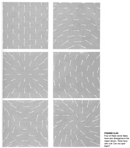

I do use his attempt to give the student some intuition of what divergence and curl mean
using his page of field patterns
Six square panels, labelled (a) to (f), each showing a field of white arrows on a grey background, with the arrows pointing in different patterns such as radial, circulating and uniform.
This is not done in the typical introductory level and it's not done in Griffiths.
Tom Moore's Six Ideas That Shaped Physics Unit E (which i mentioned earlier)
uses similar ideas to try to give some intuition to divergence and curl.
When I last taught E&M, I tried to build on these idea using GeoGebra
"Vector Fields, Divergence and Curl, and Flux and Circulation Integrals (robphy)"
https://www.geogebra.org/m/vkhy5eza
