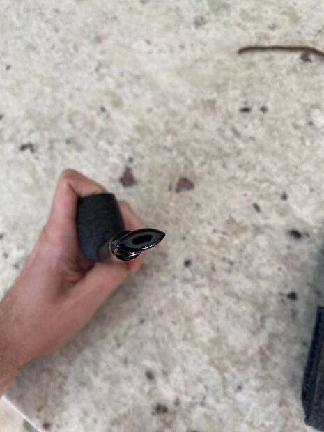

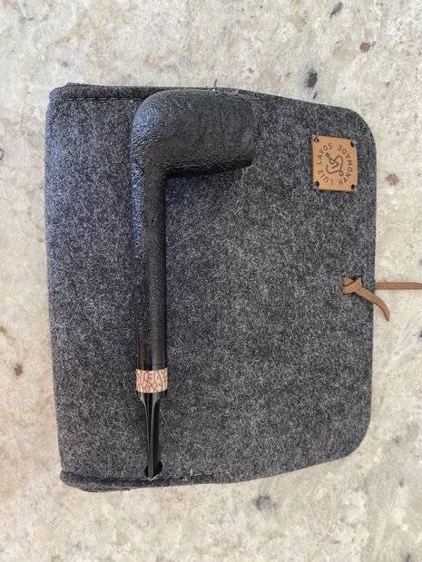

Hi everyone! Forgive me if this is posted in the wrong part of the forum and thanks in advance for any insight here.
I'm a pipe smoker and I just received a very nice artisan pipe that has an issue that is completely unique in my experience (and that of the pipemaker). Basically, when drawing air through the pipe the airflow starts out smooth and open but very quickly starts to feel restricted, almost as if something were caught in the airway. It's doing this without anything being packed in the bowl and it happens every single time when pulling on the pipe directly straight.
If I manipulate the way the air is being pulled through the pipe by changing the angle that the pipe is facing my mouth, the draw seems to open back up. I have double checked that the airway is clear by shining a light into the bowl and there is nothing obstructing it. It feels almost as if there is a sort of suction being created somehow when air is pulled directly through the pipe but my understanding of physics is too elementary (read nonexistent) to know why that might be happening or even if that is what's happening.
The pipemaker is similarly perplexed so I figured I'd reach out to a group much more well versed in physics than myself. It's a long shanked Lovat style pipe and the airway is drilled at 4 mm. My suspicion is that the dimensions of the pipe happen to be in a sort of "sweet spot" that is creating the issue. Does anyone know what might be going on? If so, anything that might be a simple fix? Thanks for any help!

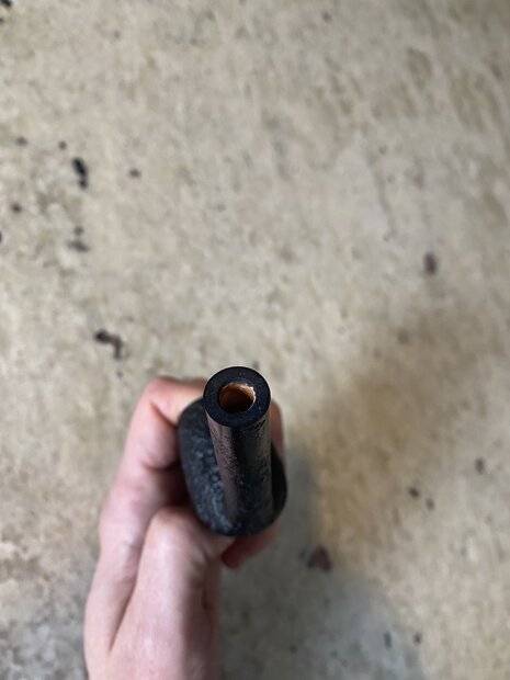

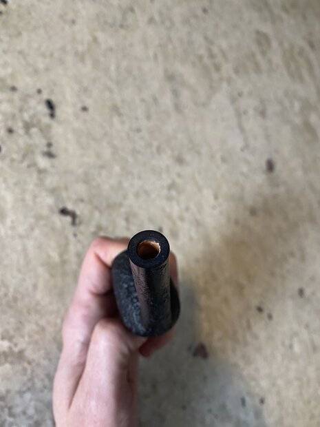

Have used a pipe cleaner but I can also look straight down it with a light shining through the bowl and see the entire airway through to the bowl. There is nothing in the airway or bowl except for smooth, bare wood all the way down.
Here's a photo showing the lack of coating on the bare wood that goes all the way down the pipe.

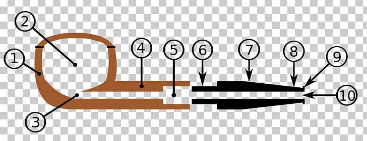

I know you said you already have a 4 mm channel but you should check for sharp corners and eliminate them. Setting a chamfer - a fillet is even better - at any inlet or outlet will also help reduce turbulences.
Also, check for misaligned channels between pieces. In the image below, the inside bore at 4 should be perfectly aligned with the inside bore at 6.

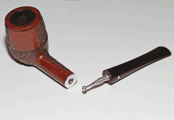

What an interesting problem. On pipesmokersden, I came across a hypothesis about the effect of a flat-faced tenon on laminar flow within the draft hole. The gentleman (Sasquatch) proposed beveling/funneling the end of the tenon to reduce turbulence.
It seems logically sound though I don’t have any personal experience with this type of modification.
