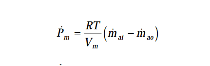

amare
What-will-happen-if-the-air-entering-to-the-intake-manifold-is-smaller-than-the-air-entering-the-cylinder-from-the-manifold?
the following expression is the rate of change of the manifold pressure interms of the mass flowing to the manifold and the mass of air flowing to the cylinder from the manifold. if the air flow to the manifold is zero the manifold pressure will be negative. what does it mean having a negative pressure?

Are you not familiar with 'absolute pressure' versus 'gage pressure' ?
All it means is 'absolute pressure' inside the manifold is less than outside it.
That's why most people call it 'manifold vacuum' instead.
Were there no vacuum what would make air flow into the manifold ?
Actually your expression is telling you the rate of change of pressure is negative, not the pressure itself.
243953
It's P with a dot above, not just P.
When there's no more air to pump out of the manifold pressure inside it will stop decreasing, of course.
There cannot be an absolute pressure less than zero .
That's why we have to be careful in using formulas , so we don't try to apply them beyond the natural limits imposed on them by Mother Nature..

oh i noticed it is the rate of pressure that is negative ! thank you very much ... please help me ! i am modeling and engine in simulink. under normal condintion every thing goes ok with the model on simulink. but I want to design a control valve to be installed between the throttle body and the intake manifold to restrict the flow of air when the vehicle is overloaded ( passenger over loaded for example). so if the vehicle is over loaded (than the required), the airflow to the engine will be blocked by the valve ( not by the butterfly valve in the throttle body) even if the driver press the gas pedal and open the butterfly valve in the throttle body. that means airflow to the intake manifold will be blockd and the engine is expected to stop ! . but in the simulink model the engine speed is not zero. it is negative valve …… because the above equation has a negative valve since the rate of air flow to the manifold is zero ( blocked by the control valve). that is my problem ... the engine model is like in the link below . but i added a control valve model in the throttle and manifold submodel to control airflow. the simulation gives me negative engine speed
https://ch.mathworks.com/help/slcontrol/examples/linearization-of-an-engine-speed-model.html

Yes that's the trouble with linear equations they don't recognize natural limits that make physical processes nonlinear.
I am unfamiliar with Simulink.
Were i doing this in Fortran i would place a lower limit on manifold pressure.
An engine (or any other single stage piston pump) cannot reduce manifold pressure to less than
(its discharge pressure) divided by (its compression ratio),
you should think for a while why that is so.
So that places a lower bound on your manifold absolute pressure and it is a positive value.
old jim
