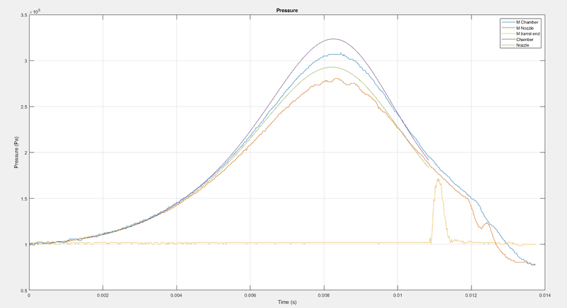

Hi have been sick last couple of days, but have been able to measure the pressure in the chamber and in the barrel (add the exit of the nozzle) and the pressure in the barrel right at the end (when the bb exits).
It seems that the pressure in the chamber is a bit higher then what is measured so need to recheck all the measurements (initial air-mass and the mass-air-flow) the ratio between chamber and barrel/nozzle pressure seems to be in the right area. Think if I can get these to match the simulation completely matches reality. So maybe the assumption that the bb sees another force might be incorrect.
Also noticed that the pressure normally is dropping below ATM when the piston is going backwards. so in the measurement above I made sure the spring was already compressed.

I believe the yellow spike in pressure is acting over the length of the barrel. I think it shows the magnitude is not insignificant. It is working against the projectile as the static gas in the barrel before the spring is released is accelerated out of the barrel ahead of the projectile. That pressure increases the pressure in the chamber that is pushing the projectile relative to a model that doesn’t consider it.
If the bb is already out of the barrel than that pressure is just the pressure behind the bb as it exists ( and I'm mistaken)
What is the timing of the spike relative to the bb position?
The pressure spike is just as the BB passes the sensor and just before it exits the barrel. I went a step back and did a measurement with the barrel and no BB but I closed the barrel on the end. Same as I did with only the cylinder. But is pretty far off.
So this is with no barrel and closed cylinder:
Pretty good match sim vs measurement
Below is the same but then with a 300mm (6.05mm barrel) connected.

Just notiched that the pressure in the barrel is not the same as in the chamber but accoring to the measurement it was. Most likely due to the fact that my "nozzle" MFR calculation only works one way.

I have tried to verify all the measurements but so far no succes in lowering the pressure in the simulation. I also found out that when I added the pressure sensor I got extra leakage which caused the difference between simulation and measurement. I have fixed that as good as possible.

It matches now pretty well, the only small difference is that according to the simulation the BB is sooner out of the barrel then measurement. But there is also a big difference on the left (the right line) in pressure this is probably due to non-linear effect when the air is starting to moving and probably way to difficult to model.
So far I'm pretty happy with the results especially with all your help and tips. Still have some discrepancies between the measured spring constant and the measured weights to get the model to fit. I assume that the spring I used is in reality not 100% linear.

I'm not accounting for dynamics like inertia and any sensor dynamics so oscillations after the main peak are not captured. Here are some other results:

No CFD is used, only ODEs and algebraic equations that are embedded in the components. For the inlet pressure drop I used a contraction correlations per " IdelCik I.E., Handbook of hydraulic resistance, Third edition, Begell House Inc. 1980" that is embedded in the code. The correlation assumes fully developed flow before and after the contraction, so it is just an estimate here and not predictive. For pipe friction it defines a friction factor through the 'Nikuradse Harp' based on the pipe roughness and Reynolds number. For the outlet friction I used an orifice defined by a flow coefficient that I 'tuned' to get the right response. I could have used and expansion but that again would assume fully developed flow before and after.
Here is a plot of the pressure with varying flow coefficients (cq). I used cq=0.9 to match the test data:
