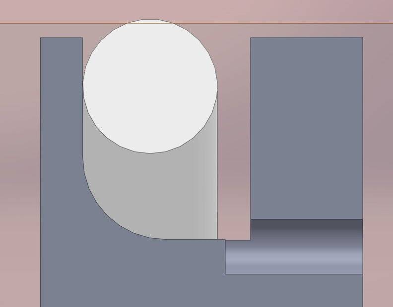

Trying to model a piston that compresses air and pushes it out of a nozzle
Hi,
I'm have been trying to model an airsoft replica, as an electrical engineer fluid dynamics, thermodynamics is a complete new flied for me and with with help of Ai i have been learning a lot about this subject. So far I have come a long way in making something my first model sort of worked but the output energy was about 40% higher then actual measurements. So i have been trying several things to see where the losses are and how to model them using Matlab. To make things a bit simpler I removed as many components as possible to make the model in steps.
So the first part I'm now trying to model is a cylinder (with diameter of 23.85mm) with a outlet on one end that is 4.5mm in diameter and 35mm long and on the other end there is a piston which will compress the air and push it out of the smaller hole. The piston is driven by a spring (150mm spring with 692N/m springconstant and pre compressed to a length of 55mm).

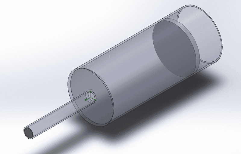

So the model looks like this
CAD render of a cylinder with a small tube outlet on one end and an open far end, with a piston inside near the closed end.

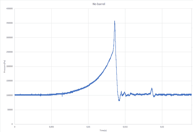

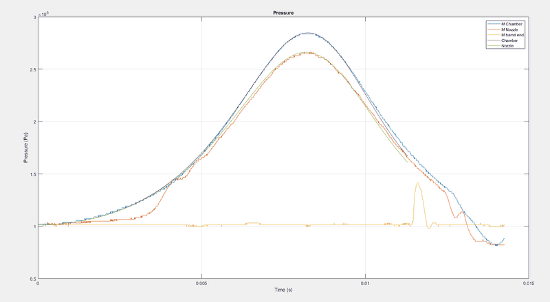

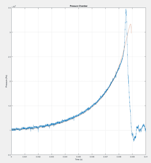

I measured the pressure inside the chamber using an absolute pressure sensor and the graph looks like this:
Line graph titled No barrel of pressure in Pa against time in s from 0 to 0.024 s. Pressure stays near 100000 Pa, rises gradually to a sharp peak of about 355000 Pa near 0.0135 s, then drops below 100000 Pa and settles with small oscillations.
The pressure peaks at 350kPa when the piston slams into the end of the cylinder from what I conclude is that the flow gets choked at 250kPa (more rapid rise).
From what I so far know and assume is that all the "losses" is due to the friction force of the oring (to create the seal of the piston) which is pressure depended and the fact that the air needs to be pressed through a hole. For now I modelled this using the orifice formula which i'm not sure if the correct way I also tried the sudden contraction formula but that doesn't seem to fit at all.

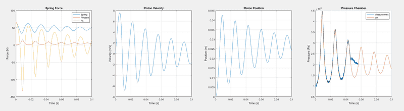

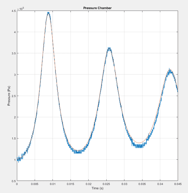

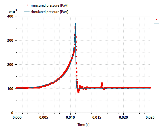

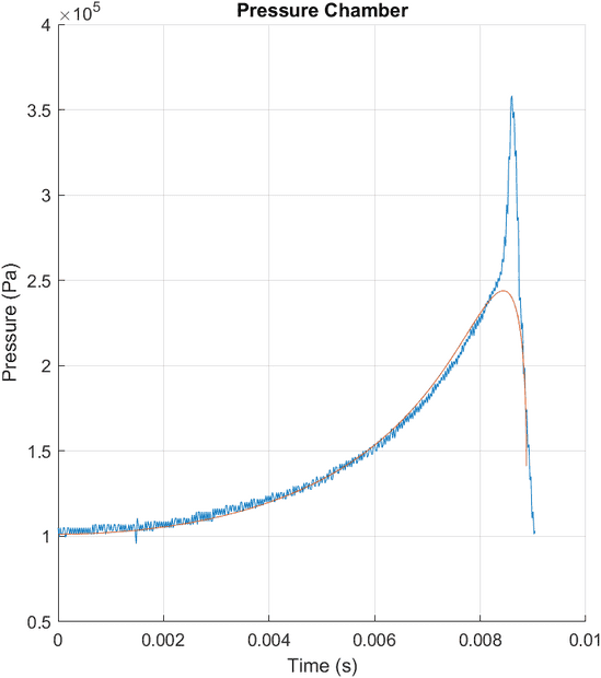

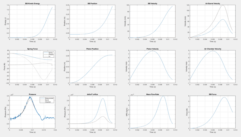

So below is a picture of the simulation vs the measured data of the pressure inside the cylinder
Line graph titled Pressure Chamber, plotting Pressure (Pa) against Time (s), with a blue measured curve and a red model curve. Pressure rises slowly from about 1.0×10^5 Pa, then climbs steeply to a sharp peak near 3.6×10^5 Pa at about 0.0086 s before dropping.
So the simulation is pretty close except that the peak is missing in the simulation, so either the simulation is wrong or the measurement is wrong (pressure is measure through a hole on the side of the cylinder right before the endstop).

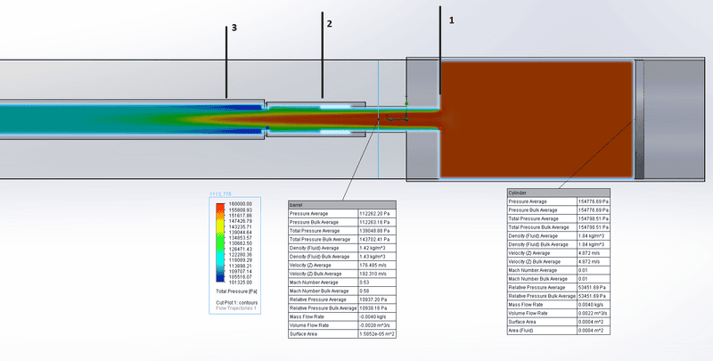

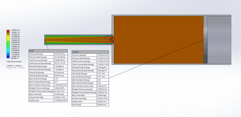

I used CFD simulation to see what I could expect and got the following results:
CFD contour plot of total pressure in a barrel and cylinder, with a colour scale from about 98786 Pa (blue) to 186602 Pa (red), and summary tables for the barrel and cylinder.
The inlet is a mass air flow of 50gr/s and the outlet is a static presure of 101325 pascal. From the total pressure inside the cylinder and ATM I have a pressure difference of 74kPa which I used to calculate the Coefficient of discharge value which is about 0.85. But the simulation gives different pressure values (static, dynamic, relative and total pressure) for the inlet (on the right) and the outlet (on the left) I'm not sure any more which one to use especially of the left side (pressure average is 101325, total pressure average is 151371 pascal so not sure which one to use). If use the total pressure only the pressure difference between inlet and outlet is only 23888 pascal which seems very low and would not explain why the pressure inside the cylinder is 175kPa. Here is really the lack of knowledge to understand what is happing here.

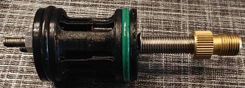

Maybe just try to focus in on what is happening to the piston. You have a known force from the spring (at least idealistically), known piston mass. What you don't know is the contact friction force from the seal of the piston from cylinder and the internal pressure acting on the piston face. Unfortunately, I think that pressure is very complex behaviorally. My guess is the gas is basically rapidly compressing before any flow initiates. I think the flow viscosity would be critical to that.
What do you get for the pressure in the nozzle if you compress it adiabatically the initial volume cylinder + nozzle volume down to the volume of the nozzle?
If the i do P1V1^1.4=P2V2^1.4 would be P1*V1^1.4/V2^1.4= 20MPa.
The part of the piston with regarding spring force and mass are easy to model but without friction of pressure it would be to fast.

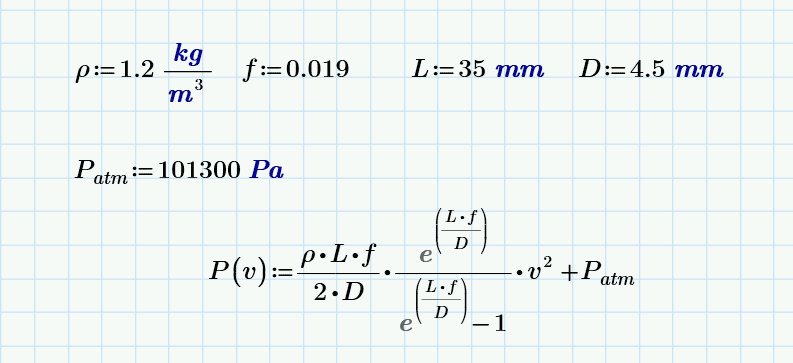

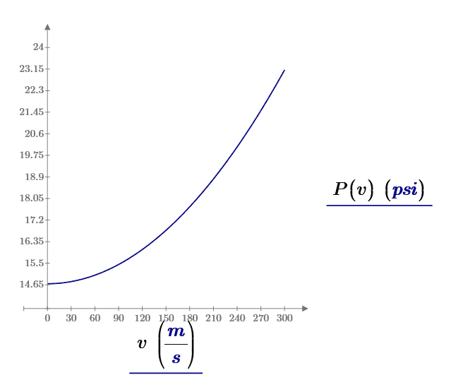

The Darcy Weisbach Equation is developed under the assumption of steady - fully developed- incompressible flow. I have worries there for applicability to this type of problem as it is literally everything but those assumptions.
The thing is if it is reaching 0.4 MPa viscosity has to be responsible IMHO. If there were absolutely no viscosity, the gas should just slip out the barrel without a pressure gradient. However, I'm not sure to what extent purely accelerating the mass of air in front of the piston out the barrel is responsible for the pressure rise. Trying to apply Bernoulli's ( steady - inviscid flow) here to find a pressure is also a mistake in my estimation for some of the reasons above - very unmatching problem assumptions validate Bernoulli's.

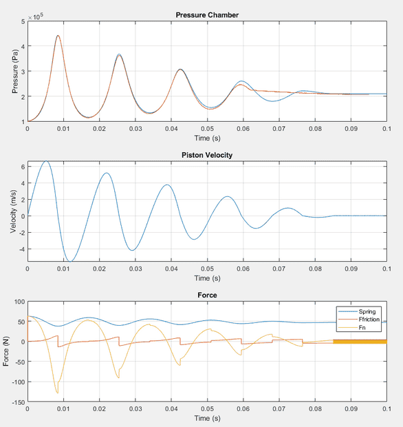

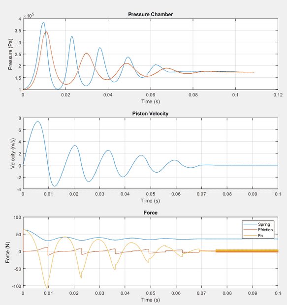

I just found an error in the mass flow rate calculation 🙈, I updated the main post. There are small differences but that the big peak is not in de simulation. Could be a measurement error.
So lets assume the calculations are correct then I still am doubting about the high friction coefficient of the oring. Im planning to make a cylinder with movable piston on 2 sides which can be pressurized to measure the friction force while under pressure.
Next step would be to add the barrel to the nozzle and model the losses there which I was planning to do based on the darcy-weisnbach and pipe-loss but as you mention that doesnt work for compressible flows. Maybe have to look more at the fanno flow model.
It's probably not measurement error. The piston is getting close to the end wall, and restricting the air flow through the orifice. The air flow out is restricted, the piston has inertia, so the pressure rises rapidly. It's nice to see that your pressure measurement / data acquisition has enough bandwidth to see the pressure spike.
The mechanical vibration from the piston hitting the end could cause an error in the pressure sensor. You could try isolating the sensor with a very short length of rubber hose, but the increased dead volume would cause other problems.

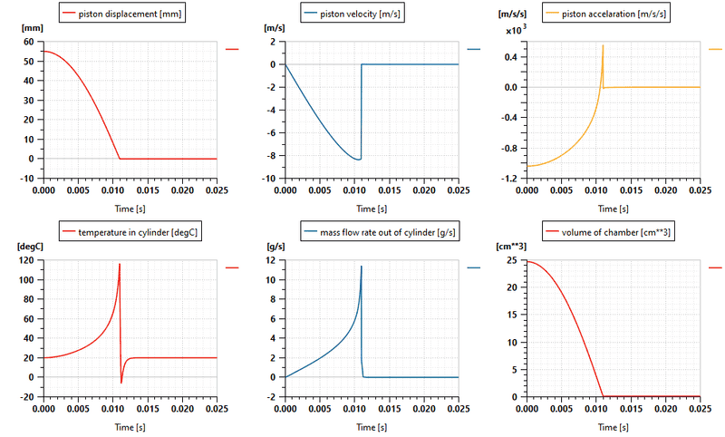

I did not check your calculations, but the approach you listed in Post #1 looks correct. I once wrote Matlab simulation code for a similar problem. My project was to move a 45 pound mass 9 inches in less than 150 milliseconds without slamming or bouncing. We were able to move that mass smoothly and quietly in as little as 120 msec.

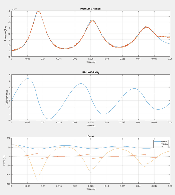

My code output very nicely matched measured pressures and piston accelerations. I modelled the output as an orifice with either subsonic or choked flow. The flow restriction at end of stroke was not a problem because my model was for using an air cylinder to decelerate a moving mass, so the velocity approached zero at end of stroke. I assumed polytropic air compression. Your process happens faster, so your use of adiabatic looks good to me. My model did correctly simulate the piston bouncing off the air cushion when the output restriction was too small, and slamming into the end when the output restriction was too large.

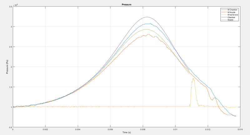

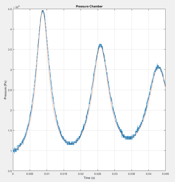

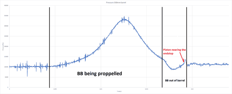

This is the measurement with a barrel of 300mm connected (diameter is 6.05mm, slightly larger then the 4.5mm of the nozzle)
Line graph titled Pressure Chamber, plotting Pressure (Pa) against Time (s) with pressure scaled by 10^5. A blue noisy curve rises from about 1.0 to 3.35 x 10^5 Pa near 0.0092 s, then drops sharply to about 1.0 x 10^5 Pa by 0.0096 s. A red smooth curve rises to about 2.45 x 10^5 Pa near 0.0085 s, then falls to about 1.4 x 10^5 Pa at 0.0089 s.

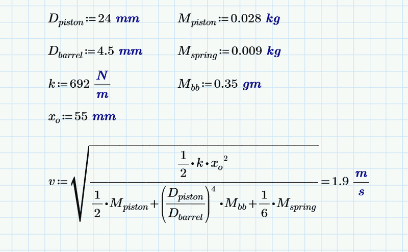

What is the mass of the piston, I'm trying to do some sanity check calculations?

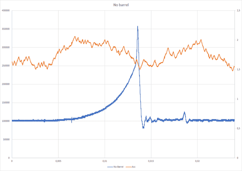

If you have access to an accelerometer, you can do a sanity check for the end of stroke pressure spike. Measure the cylinder acceleration in the direction of piston motion for a normal stroke. Locate the accelerometer as close as possible to the pressure sensor. Then tap the cylinder with a soft hammer until you can approximately duplicate the magnitude and duration of the end of stroke acceleration, while measuring the output of the pressure sensor. Remove the piston for this test. Any resulting output from the pressure sensor is due to the acceleration.
My restriction was a needle valve. I made no attempt to calculate a ##C_v## for the needle valve. We adjusted the needle valve, measured the acceleration of the system, and adjusted the polytropic coefficient and ##C_v## value in the program until the simulation results matched the measurements. The simulation results included both cylinder pressure and system acceleration. That's my recollection, this work was done 20 years ago, and all notes were left behind when I left the company.
mass of the piston is 28 gram and the spring is 9 gram.
Already tried the accelerometer but data wasn't very useful or repetitive

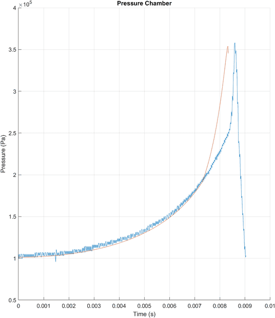

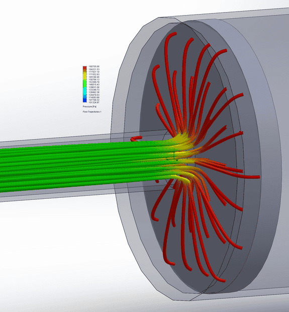

So what I think happens the Cd value drops when the piston comes near the end and therefor the pressure rises
CFD flow trajectory plot of air flowing out of a cylinder toward a disc, with green streamlines entering from the left and red streamlines curving around the disc face; a colour legend for pressure in Pa sits on the left.
Below is a plot of the complete system
Line graph titled Pressure 300mm barrel, plotting pressure in Pa against time in s; pressure rises to a peak near 0.01 s, dips below ambient, then recovers, with labels BB being proppelled, BB out of barrel and Piston nearing the endstop.
Unfortunately, I don't believe the discharge coefficient ##C_d## derives from first principles with any simplicity (maybe not at all?). So, you might be stuck with empirical results or CFD models.

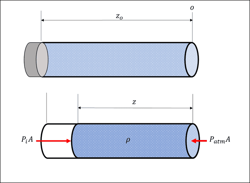

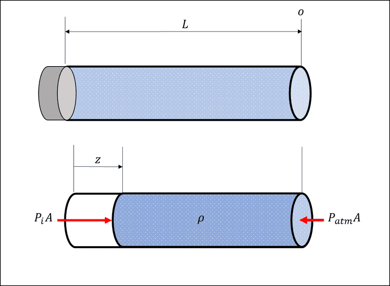

$$ \frac{- \pi D_p^2}{8} \rho \left( \frac{D_p^4}{D_b^4} - 1 \right) \dot x^2 + k \left( x_o - x \right) - \left( M_p + \frac{1}{3}m_s \right) \ddot x = 0 $$
Where
## D_p## Diameter of piston
##D_b## Diameter of barrel
## M_p## Mass of piston
##m_s## Mass of spring
##\rho## density of air at some point between atmospheric and 0.4MPa

I'm bit struggling on which mass air flow rate formula to use for my model, i have been watching and searching a lot about the formulas and there seem to be a lot of different variants. Some use the differential pressure and some use the mach number and stagnation. But since i don't know the stagnation properties (because I don't know the mach number at the orifice). I made a MATLAB script to calculate the Cd value but doesn't really seem to match with the simulation below if I do it for the 3 stages separately.
[CODE lang="matlab" title="Matlab Cd script"]m_dot_simulated=0.004;
d_orifice = 6.05e-3; %Orifice diameter
A = pi * (d_orifice/2)^2; %Orifice Area
P_in = 154776; %inlet pressure
P_out = 144000; %P2 pressure
V=209; %Velocity (m/s)
gamma=1.4;
T = 293; % Temperature in Kelvin (20°C)
R = 287; % Specific gas constant for air (J/kg·K)
% T=T*(P/101325)^((gamma-1)/gamma);
rho=P/(R*T);
ratio=P_out/P_in; %Needs to be above 0.5283
if ratio>0.5283
m_dot = A * P_in * sqrt(gamma/(R*T)) * (P_out/P_in)^(1/gamma) * sqrt(2/(gamma-1)*(1-(P_out/P_in)^((gamma-1)/gamma)));
else
m_dot = A * P_in * sqrt(gamma/(R*T)) * (2/(gamma+1)^(gamma+1)/(2*(gamma-1)));
end
C_d_orifice = m_dot_simulated/m_dot;
fprintf('Cd value for orifice: %.4f \n', C_d_orifice);
fprintf('Pressure ratio (>0.528 for subsonic): %.4f \n\n', ratio);[/CODE]

I made a test piston with 2 orings which I put under pressure with a compressor and at 300kPa in a cylinder. I measured about 16N of friction force (but this is with 2 orings and some airleakage) so it is for sure that this is a dominant part.

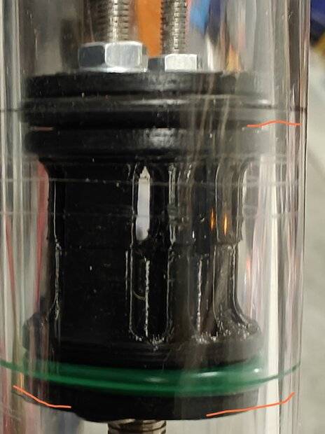

Photo of a disassembled air cylinder piston: a black plastic body with a green O-ring, a threaded steel rod with a hex nut, and a brass fitting on the right end.
and then there is the force of the compression on the piston.

Four side-by-side time-series plots of a piston simulation over 0 to 0.1 s: spring force, piston velocity, piston position, and pressure chamber measurement against simulation.
@Chestermiller this was a very good tip thank you, I added the damping factor times velocity. Only the frequency seems a bit of.
If i tune the friction coefficient to 0.5 and increase the spring constant from 692N/mm (which i measured with force meter) and change it to 735N/mm even the frequency now perfectly matches.
Four side-by-side plots over time from 0 to 0.1 s: spring force with spring, friction and Fs traces, piston velocity oscillating and decaying, piston position oscillating, and pressure chamber measurement against a model curve.

The normal force at the wall is not based on the gas pressure. It is based on the force fit of the o-ring (which is constant).
Is the region behind the piston where the spring is located open to the atmosphere, or is it a closed chamber?
In this case due to the design of the piston most of normal force is dependent on the pressure, because when the piston is moving the air will push the oring to the cylinder wall. On the front of the piston there are small hole that channel the air to the inside of the oring. So when the piston moves back there is no air seal anymore and then only the normal force die to the force fit is present.
Photo of a black piston inside a clear cylinder, with a green O-ring around its lower section and two hex nuts on a threaded rod at the top.
On the bottom you can see the Green Line of the contact area of the oring when the pressure is remove the Green Line disappears.
This is what the section view looks like.
Cross-section CAD view of a piston groove with a circular O-ring seated in a rounded-corner groove, shown as a white circle against the grey groove walls.
The backside of the piston is open to atmosphere
Tried adding adiabatic temperature rise but seems it is not happening
Simulation with static tempeature
Line plot titled Pressure Chamber of pressure in Pa against time in s from 0 to 0.045 s, showing a noisy blue measured curve and a smooth orange model curve; three peaks near 4.45e5, 3.6e5 and 3.1e5 Pa with troughs between them.
Simulation with adiabatic temperature rise
$$\text{Temp}(n) = T \left(\frac{P(n)}{P_0}\right)^{\frac{\gamma - 1}{\gamma}}$$
Line plot titled Pressure Chamber of pressure in Pa against time in s, with a blue noisy measured curve and a smooth orange simulated curve; both show three oscillating peaks, with the simulated peaks slightly earlier and lower in the first two cycles.
If I remove the friction force and increase the piston weight to 31.7gram (instead of the 28 grams measured) i can get it to match using adiabatic temperature rise:
Line plot titled Pressure Chamber of pressure in Pa against time in s from 0 to 0.045, with a noisy blue measured curve and a smooth orange model curve. Three pressure peaks near 4.4 x 10^5, 3.6 x 10^5 and 3.1 x 10^5 Pa, separated by troughs near 1.2 x 10^5 and 1.4 x 10^5 Pa.

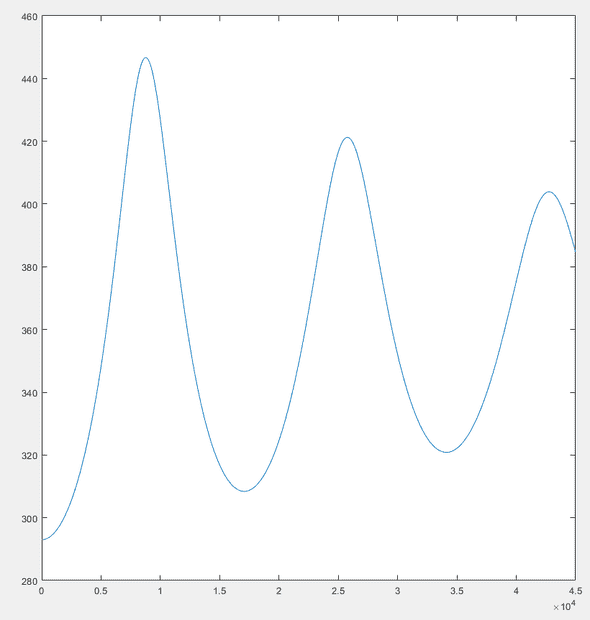

Temperature rise in kelvin
Line plot of temperature in kelvin against time step (x-axis scaled by 10^4, 0 to 4.5); the curve starts near 293, peaks near 447 around 0.9 × 10^4, dips to about 309, peaks near 421, dips to about 321, then peaks near 404 before falling to about 386.
The analysis of the exit pipe is a little problematic. Its L/D ratio is only 7.8 which is less than the hydrodynamic entrance length for both laminar and turbulent air flow. This means that the Hagen Poiseulle equation (for laminar flow) or the Darcy-Weisbach correlation (for turbulent flow) will be inaccurate for flow in this pipe, even if we could consider the instantaneous flow occurring to be at quasi steady state. It would probably be better to use the orifice equation for the entrance to the pipe and neglect the viscous drag within the pipe itself.
I found a mistake with the friction that I forgot the sign when velocity is negative
Still had to tune the mass to 31gram instead of 28gram but that is acceptable, the friction coefficient is now 0.49 which is in the range of what I would expect.
Three stacked MATLAB plots against time from 0 to 0.05 s: pressure chamber in Pa with peaks near 4.5e5, piston velocity in m/s oscillating between about -6 and 7, and force in N showing spring, friction and Fn curves.
For the second simulation I have now these results using the follwing mass flow rate formula:
For subsonic flow
\text{m_dot_orifice}(n) = C_d \cdot A \cdot P(n) \cdot \sqrt{\frac{2}{R \cdot T(n)} \cdot \frac{\gamma}{\gamma - 1} \left(\left(\frac{P_0}{P(n)}\right)^{\frac{2}{\gamma}} - \left(\frac{P_0}{P(n)}\right)^{\frac{\gamma + 1}{\gamma}}\right)}
Line graph titled Pressure Chamber, pressure in Pa against time in s from 0 to 0.01 s. Pressure rises gradually from about 1.0 x 10^5 Pa, peaks near 3.5 x 10^5 Pa at about 0.0085 s, then falls sharply to about 0.8 x 10^5 Pa before oscillating. A red fitted curve follows the blue measured trace closely until the peak.
It is not a perfect match but I think at the and the Cd values changes a lot when the piston near the end.
For the complete simulation including the ball in the barrel the pressure exactly matches the measurement (bottom left graph). But i think that the BB leaves the barrel 3ms earlier in the simulation then in reality. So either the pressure is lower in the barrel or the BB sees another counter acting force. I thought maybe the air mass that is in the barrel in front of the BB at t=0 is being compressed which decreases the net force on the BB. But not sure how to model that maybe it is the air friction using the darcy-weisbach. I ordered an light sensor to measure the exact moment the BB leaves the barrel.
Grid of twelve simulation plots over time for an air gun: BB kinetic energy, position, velocity, air barrel velocity, spring force, piston position, piston velocity, air chamber velocity, pressure with measurement, delta P orifice, mass flow rate and BB force.

So either P_barrel is lower or P_atm should be function.
So in the simulation the BB exits at point 1, but I think in reality the BB exits at point 2 because of the steeper pressure drop (this I will verify with the light sensor).
Line graph titled Pressure of pressure in Pa against time in s from 0 to 0.02 s, with two curves Barrel and Chamber plus a noisy Measurement trace that peaks near 3.3 x 10^5 Pa around 0.009 s, then falls to about 0.9 x 10^5 Pa near 0.014 s before a small rebound.

For the section 1) If we very imprecisely apply the momentum equation ignoring viscosity, and assume incompressible flow:
Diagram of a gas cylinder with a projectile: top view shows a rod of length z_o from the left end to point o; bottom view shows the gas column of length z with density rho, pressure P_i A pushing right on the left face and P_atm A pushing left on the right face.
$$ \sum \boldsymbol F = \frac{d}{dt} \int_{cv} \rho \boldsymbol{v} d V\llap{-} + \int_{cs} \rho \boldsymbol{v} \left( \boldsymbol{V} \cdot d \boldsymbol{A} \right) $$
Since we aren't varying the cross sectional area (or the density across the control volume - incompressible flow assumption) the control surface terms on the right sum to zero.
And we are left with (one dimensional):
$$ \left( P_i - P_{atm} \right) A = \frac{d}{dt} \int_{cv} \rho v ~d V\llap{-} $$
$$ \left( P_i - P_{atm} \right) = \rho \frac{d}{dt} \left( -\dot z \int dz \right) \tag{1}$$
Taking the derivative:
$$ \implies P_i = P_{atm} - \rho \left( \dot z^2 + z \ddot z \right) $$
( I'm not certain on the sign - I think ##\ddot z < 0 ( \dot {\boldsymbol{v}} = -\ddot z \boldsymbol{ \hat{z}} ) ##, hence the negative term )
##z## is the length of the barrel ahead of the projectile
##P_i## is the pressure acting on the projectile from ahead
Even with this basic assumption model we still get pressures to analyze that retard the motion of the projectile.

I believe I was sloppy in deriving (1). I would instead take ##z## as originating from the barrel entrance:
Two schematic diagrams of a cylindrical barrel: the top shows total length L with an outlet marked o; the bottom shows a slug of fluid density rho at distance z from the entrance, with pressure P_i A pushing in from the left and P_atm A from the right.
Now the equation becomes:
$$ \begin{align}P_i A - P_{atm}A &= \rho A \frac{d}{dt} \left( \dot z \int_{z}^{L} dz \right) \tag{}
\\&= \rho A \frac{d}{dt} \left( \dot z L - \dot z z \right) \tag{}
\\&= \rho A \left( L-z \right) \ddot z - \rho A \dot z^2 \tag{} \end{align} $$
I hope someone can verify that the math appears to be sensible.
EDIT: I don't like the term ##-\rho A \dot z^2##. If I go ahead and look at Newtons second for a force ##F## acting on the projectile from the chamber:
$$ F - P_iA = m \ddot z $$
If I sub in ##P_i A## I get something that seems wrong for the EOM:
$$ F - P_{atm}A - \rho A \ddot z (L-z) + \rho A \dot z^2 = m \ddot z $$
That last term on the LHS is very suspicious because it is the same direction as ##F##, and I expect all forces other than ##F## to be resistive in nature.
Anyone see the mistake I'm making?
