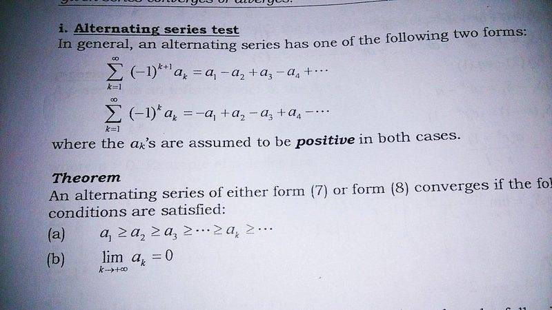

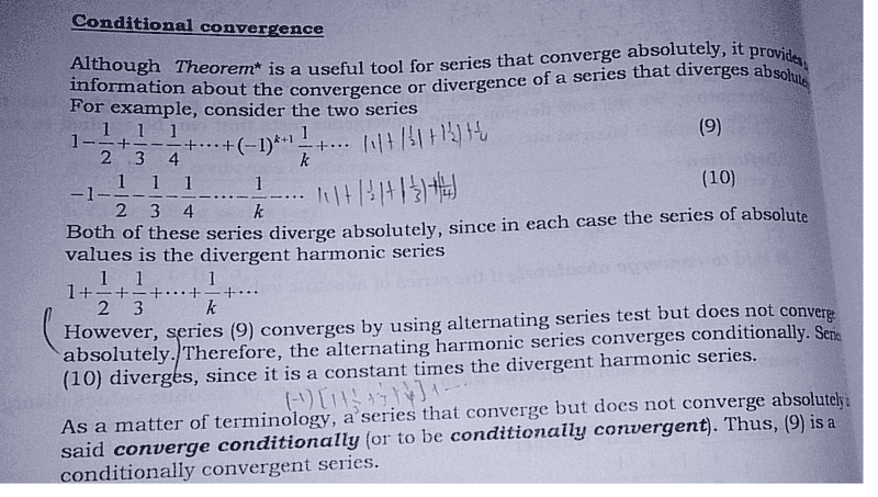

why the author said the series 9 converges by using alternating test ? for the alternating test , the first term the sequence must be in descending order , the it is said to be converges , right?
however , in series 9 , 1 is >(-1/2) , but (-1/2) is not > (1/3)

But 1/2 > 1/3, etc., and that is all that matters. You need to read the material more carefully.

This makes no sense, "the first term the sequence must be in descending order". For descending order you have to look at the first tem, second term, and so on.
You need to read the conditions that must be met for the alternating series test to be used.
