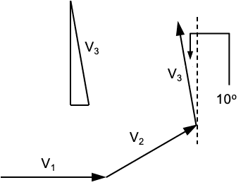

An ant walks on a piece of graph paper straight along the x axis a distance of 10.0 cm in 2.00 s. It then turns left 30.0° and walks in a straight line another 10.0 cm in 1.80 s. Finally, it turns another 70.0° to the left and walks another 10.0 cm in 1.55 s. Determine (a) the x and y components of the ant’s average velocity, and (b) its magnitude and direction.
N/A
I am having trouble with finding the x and y components of V3 . According to various different websites the correct way to find the components of V3 is
Vx=10*cos(100) and Vy=10*sin(100). I can see where the 100 comes from, the previous vector was already traveling 30 degrees and now V3 swung out an additional 70 degrees.
The way the angle is in this triangle i sketched for V3, the opposite side of this angle presents the length of the x component. The opposite side is traveling in the X axis. Likewise, from this angle the adjacent side is traveling up which in opinion is the length of the y component.
So from my perspective to find the x and y component I should solve for
Vx=10*Sin(100) and Vy=10Cos(100).
But this answer doesn't match up with other answers.
Could some help me understand if and why I am viewing this wrong?
Work is attached in PDF
Vector V3 only deviates 10° from vertical; therefore, its x and y components should refer to that angle: V3x << V3y
##V_{3x}=10\cos(100^o) =-10\sin(10^o)##
##V_{3y}=10\sin(100^o) =10\cos(10^o)##

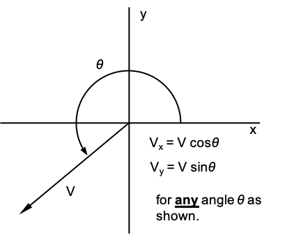

Take your pick. You can always write the x-component as ##V_x=V\cos\theta## as long as ##\theta## is measured counterclockwise from the x-axis. Then you don't have to worry about right triangles. It's OK to have angles greater than 90o, they automatically take care of the negative signs. Needless to say, with this angle convention the y-component is always ##V_y=V\sin\theta.##

What triangle? Shown below is a diagram drawn to scale. The only right triangle relevant to V3 is shown as an inset where V3 is the hypotenuse. The angles opposite to the right sides are 10o and 80o. It's obvious which is which. Clearly
V3x = -V3cos80o = -V3sin10o
V3y = V3cos10o = V3sin80o

Ok I worked it out again to try to understand. I believe using V3x = -sin10o and V3y = cos10o makes the most sense to me as shown in my new attached work. Could you help me visualize V3x=10cos(100) and V3y=10sin(100)?
See picture. For 0 ≤ θ ≤ 2π, the tip of vector V traces a circle which is the unit circle scaled by the magnitude V. In this particular example V = 10 cm and θ = 30o + 70o = 100o.
