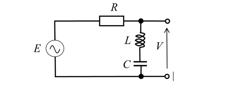

Calculate V/E of the circuit below. I tried to calculate this one, is it correct? Thank you
Vc = 1/jwC
Question
Circuit schematic: an AC voltage source E in series with resistor R feeds a branch of inductor L and capacitor C in series, with output voltage V taken across that LC branch.
Answer;
Typeset answer: the magnitude of V over E equals 1 divided by the square root of 1 plus wC times (Rj plus wL).
That does not look right to me.
You have a potential divider.
Reactance; Xv = XL + XC;
But what is the sign of XC ?
Impedance; Ztotal = R + jXv
The output V = E * jXv / Ztotal

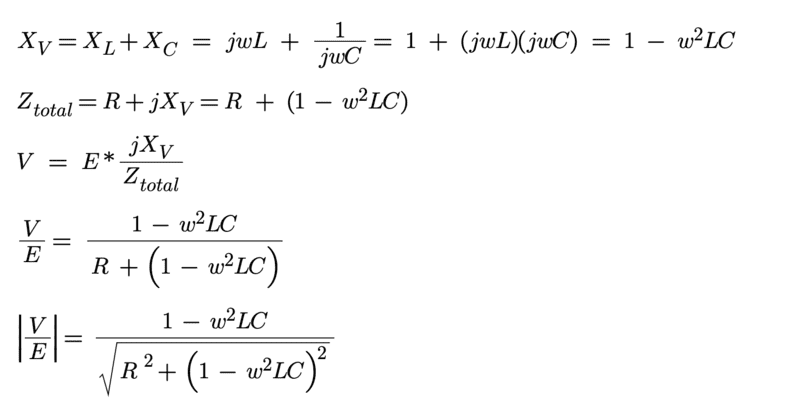

How about this one?
  • Typeset derivation of an RLC series circuit: reactance X_V = X_L + X_C = jwL + 1/(jwC) = 1 - w^2LC, total impedance Z_total = R + jX_V, voltage V = E*jX_V/Z_total, V/E as a fraction, and its magnitude |V/E| = (1 - w^2LC) / sqrt(R^2 + (1 - w^2LC)^2).
2nd guessing will not educate you, nor solve the problem.
At the frequency where L and C are resonant, there will be a deep notch with V = 0.
How can XL + XC = 0 ?

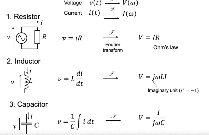

What is the reactance XL of an inductor?
What is the reactance XC of a capacitor?
based on my class, here it is
  • Slide comparing resistor, inductor and capacitor under Fourier transform: v = iR becomes V = IR, v = L di/dt becomes V = jωLI, and v = (1/C) ∫i dt becomes V = I/(jωC).
Both XL and XC are imaginary. R is real.
So XL + jXC does not equal Xv. Both XL and XC lie on the same axis.
Xv = ωL - 1/ωC

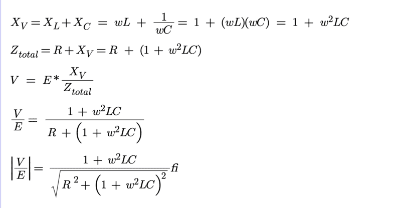

Then, I remove the imaginary, how about it?
  • Handwritten-style typeset derivation of the magnitude of V/E for a series RLC circuit: X_V = X_L + X_C = wL + 1/(wC) = 1 + w^2LC, then Z_total = R + (1 + w^2LC), V = E·X_V/Z_total, and |V/E| = (1 + w^2LC)/sqrt(R^2 + (1 + w^2LC)^2).
You must move more methodically and accurately.
You removed the j, but immediately ignored the negative sign, then forgot to divide.

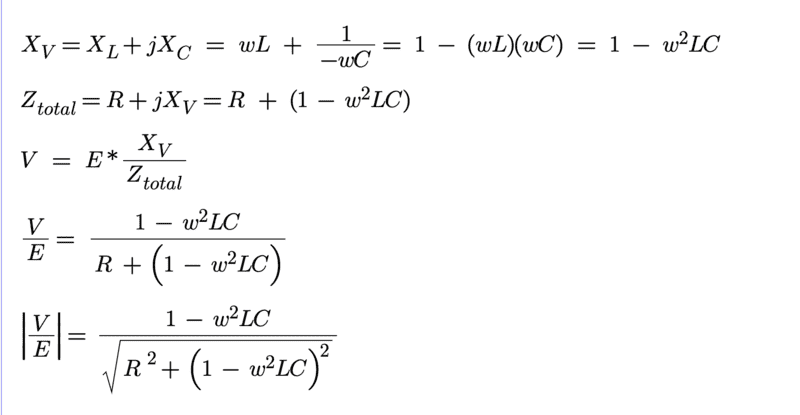

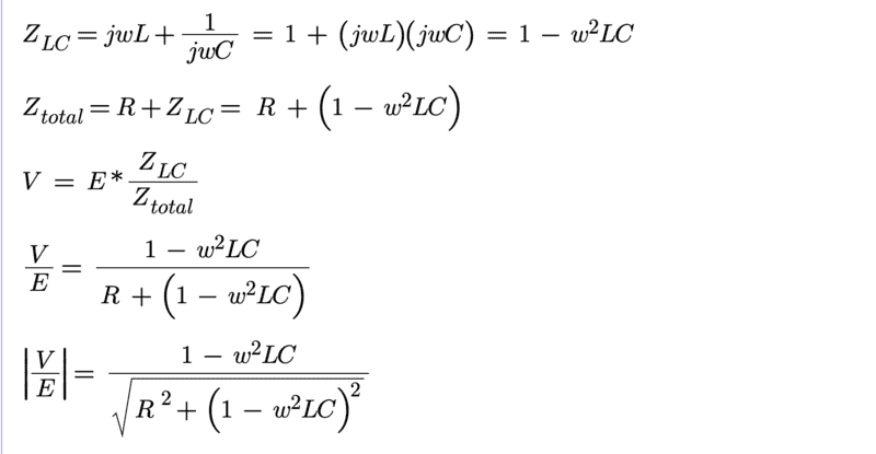

how about this? I am sorry, I am new in this area so kinda confused
  • Series of typeset equations: Z_LC = jwL + 1/(jwC) = 1 + (jwL)(jwC) = 1 - w^2LC; Z_total = R + Z_LC = R + (1 - w^2LC); V = E * Z_LC / Z_total; V/E = (1 - w^2LC) / (R + (1 - w^2LC)); |V/E| = (1 - w^2LC) / sqrt(R^2 + (1 - w^2LC)^2).
I wouldn't multiply XL by j, and then divide XC by j . That does not seem fair.
Z = R + j X;
If you work on the reactance, X only, you can ignore j for the moment.
You are having problems with fractions.
X = ωL - 1 / ωC = ( ωC·ωL - 1 ) / ωC .

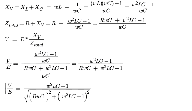

I am so sorry, I didn't realize it

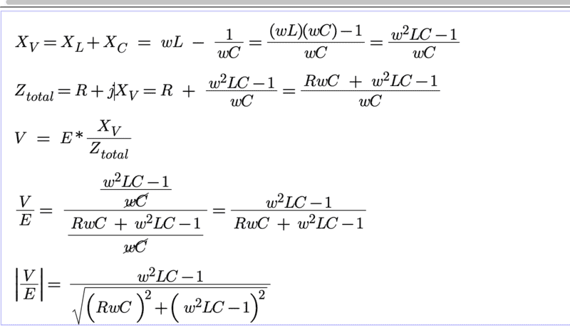

I revised again
  • Handwritten-style typeset derivation of a series RLC circuit: X_V = X_L + X_C, Z_total = R + X_V, V = E·X_V/Z_total, and |V/E| = (w²LC−1)/sqrt((RwC)² + (w²LC−1)²).
Resistance, real, is plotted along the x-axis, reactance, imaginary, is on the y-axis. Impedance is a point on the map, represented by a complex number. Below the x-axis is negative, so it is a capacitive reactance, above the x-axis is inductive reactance. Resonance lies on the x-axis, where reactance is zero.
You must introduce j when you write a complex impedance, because it keeps the orthogonal real and imaginary axes apart. Z = R + jX is prevented from becoming Z = R + X by the presence of j.
So in your second line you must carefully identify the reactance components with j .

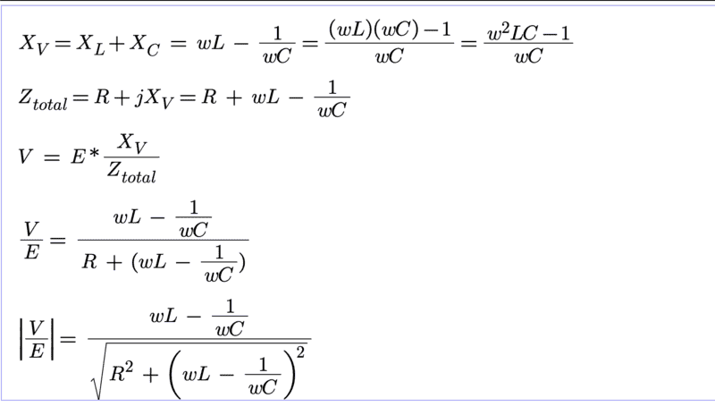

Handwritten-style LaTeX derivation of a series RLC circuit: X_V = X_L + X_C = wL - 1/(wC) = (w^2LC - 1)/(wC); Z_total = R + jX_V = (RwC + w^2LC - 1)/(wC); V = E*X_V/Z_total; V/E = (w^2LC - 1)/(RwC + w^2LC - 1); |V/E| = (w^2LC - 1)/sqrt((RwC)^2 + (w^2LC - 1)^2).
is it? do I need to change plus to minus after R in Z total? Then for |V/E|, did I put quadrat and roots correctly? should. I also put root on the top?
Now you are going to need to propagate that R + j ( ) along the second line;
That is needed to keep the impedance orthogonal.
That is needed to keep the impedance orthogonal.i
how about this? is this what you mean as propagate?
  • Typeset derivation of the voltage ratio across an RLC series circuit: reactance X_V = wL - 1/(wC), total impedance Z_total = R + wL - 1/(wC), V = E·X_V/Z_total, and |V/E| = (wL - 1/(wC)) / sqrt(R² + (wL - 1/(wC))²).
Baluncore said:
I think you need to brush up on your complex arithmetic.
https://en.wikipedia.org/wiki/Complex_number
V = E * ( 0 + j Xv ) / ( R + j Xv )
So you need to divide an imaginary by a complex.
Thank you very much, I see, I think my answer is still not correct. I ll try to learn your suggestion.
