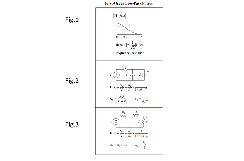

Why are R1 and R2 parallel in the NCEES analog filter circuit?
20 replies · 3K views
xconwing
NCEES Reference Handbook p.206Hi,
My question is: In Fig.2, how can R1 and R2 be parallel? If anything, it should be in series because capacitor in the long run is an open.
Thanks ahead.
Hi and welcome.
"Series" and "parallel" are just names. They are not relevant to the analysis of circuits - except for the most elementary cases. But, if you bear in mind that a voltage source (v1) has zero impedance and if you replace it with a piece of wire, then, from the point of view of the C, they are in parallel and the equivalent resistance can be calculated with that formula.
Consider form of the transfer function in the s-domain for that circuit. Introducing Rp gives a shorter way to write it down and calculate.

how did they come to the equation H(s)?
I tried to do the circuit analysis but it didn't come out the same, will put it up here when i find a decent equation editor

Let i1 be current through R1, ic current through C, and i2 current through R2.
For sine wave voltage input it holds:
i1 = ic+ i2
v1 = i1·R1 + ic/(jωC)
0 = i2·R2 - ic/(jωC)
From this you find (express) i2.
Then, H(s)=H(jω)=v2/v1= (i2·R2)/v1.
Finally, when you introduce Rp=R1·R2/(R1+R2), you'll get the result.

Nothing is missing. 2nd eq. is for the first closed loop: v1 - R1 - C and 3rd eq. is for second closed loop: C-R2.
Do you understand this?

Okay, I understand eq.1-3, 2&3 are from KVL. i2 should express from which eq.? Why v1 become a short?
i2 to be expressed as one of the solutions to the given system of 3 linear equations (other two solutions are i1 and ic but you don't need them). What "v1 become a short"? I don't understand you
Eqn 3 comes from saying "because C and R2 are connected in parallel, then the voltage across C equals the voltage across R2."
Eqn 1 comes from saying "the voltage across C equals V1 minus the voltage lost across R1".

Okay, so far the algebra checked off their final equation against my. Though I still don't understand how they see R1 and R2 as being parallel, the v1 is in the way. If you say, turn v1 into a short, why?
Not 100% sure, but my guess is they prefer approach to the problem by the method of Thevenin's theorem
In that case the filter circuit can be replaced by equivalent Thevenin's circuit with:
in order to find current and voltage of capacitor's impedance Xc :
Ugh, I see. They want to be fancy schmancy. :rolleyes:
Okay, one last thing. That omega, the way they set it up seem like RP will ALWAYs be equal to capacitor impedance. Is that the case?
