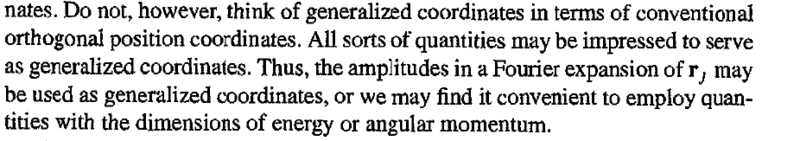

When discussing about generalized coordinates, Goldstein says the following:
"All sorts of quantities may be impressed to serve as generalized coordinates. Thus, the amplitudes in a Fourier expansion of vector(rj) may be used as generalized coordinates, or we may find it convenient to employ quantities with the dimensions of energy or angular momentum."
I understand that generalized coordinates need not be orthogonal position vectors. But what does Fourier expansion of a vector even mean? A vector has 3 coordinates, now the amplitudes of Fourier expansion are infinite. How can they be used as generalized coordinates?
I've no clue. I'd need more context from the book (which I'd read with some care, because there's at least one strange mistake concerning anholonomous constraints, which has been discussed a while ago in the textbook forum).
I suspect he means something like collective coordinates. This makes sense if what you call vector(rj) is the position of N particles indexed by your subscript, j.
He just starts talking about generalized coordinates and the transformation equations. He gives an example of the two angles theta1 and theta2 of a double pendulum and how the generalized coordinates need not be position vectors.
But that has nothing to do with Fourier transformations. Of course, a generalized coordinate can be anything describing the location of the system in its configuration space. Later you'll also learn about the Hamiltonian formulation, where you use phase space, i.e., generalized coordinates and their canonically conjugated momenta.

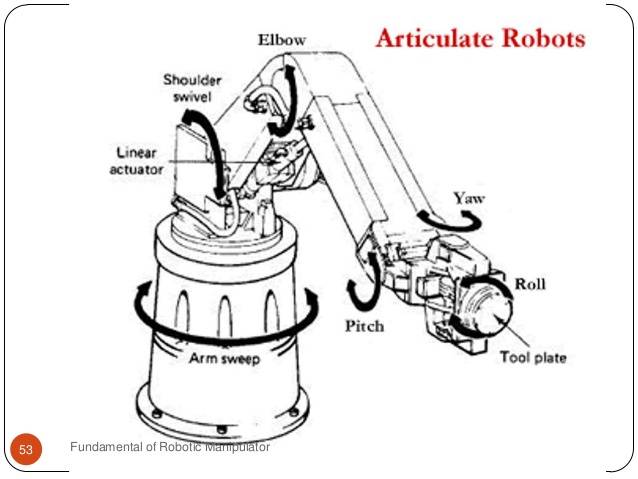

RickRazor said:
Can you explain what do you mean by requiring more than 3 coordinates for a vector in a 3D space?
There are several examples, but my favorite example is from robotics.
A robot manipulator must place its tool in the correct position (3 coordinates; x, y, z) with the correct orientation (3 coordinates; φ, ϑ, ψ) All in all - 6 coordinates.
Given the construction of the robot arm in the picture, it is fairly easy to calculate the position and orientation from the angles and lengths. The other way around is not trivial.
The vector you get from Fourier coefficients is a vector in an infinite-dimensional space. This is definitely not the three-dimensional space we are all used to living in.

But then, there was no context of infinite-dimensional space
As I already said, that's not enough context to make sense about this statement. I'd tend to think, it doesn't make sense here at all since for point mechanics you have a finite number of independent degrees of freedom in configuration space, and it doesn't make sense to use a Fourier transformation of some kind to relabel them.
This changes for the case of fields, where you have a continuous number of field-degrees of freedom, which you may either label in terms of ##\vec{x}## or of ##\vec{k}##, where
$$\phi(t,\vec{x})=\int_{\mathbb{R}^3} \frac{\mathrm{d}^3 \vec{k}}{(2 \pi)^3} \tilde{\phi}(t,\vec{k}) \exp(-\mathrm{i} \vec{k} \cdot \vec{x}).$$
