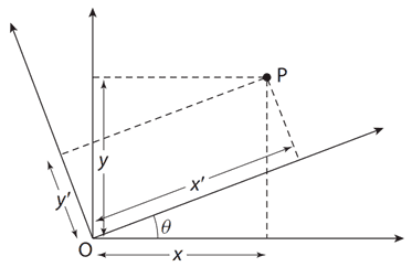

I'm reading Group Theory by A. Zee , specifically, chapter I.3 on rotations. He used the passive transformation in analyzing a point ##P## in space. There are two observers, one labeled with unprimed coordinates and the other with primed coordinates. From the figure below, he deduced the relation between the two observer coordinates,
\begin{equation}\tag{1}
x' = x \cos\theta + y \sin\theta, \qquad y' = -x \sin\theta + y \cos\theta
\end{equation}
This can be written in vector notation as ##\; \vec{r}' = R(\theta) \vec{r} \;## where,
\begin{equation}\tag{2}
\vec{r} = \begin{bmatrix} x \\ y \end{bmatrix}, \quad \vec{r}' = \begin{bmatrix} x' \\ y' \end{bmatrix}, \quad R(\theta) = \begin{bmatrix} \cos\theta & \sin\theta \\ -\sin\theta & \cos\theta \end{bmatrix}
\end{equation}
Diagram of two coordinate frames sharing origin O, with point P, dashed projection lines, and labels x, y, x', y' and angle theta between the x-axis and the primed x'-axis.

My original confusion while reading is that given the basis transforms through ##R(\theta)##, we know that the coordinates should transform inversely so as to preserve the vector ##\vec{v}##, i.e.,
\begin{equation}\tag{10}
\begin{bmatrix} \hat{x}' \\ \hat{y}' \end{bmatrix} = R(\theta) \begin{bmatrix} \hat{x} \\ \hat{y} \end{bmatrix} = \begin{bmatrix} \cos\theta & \sin\theta \\ -\sin\theta & \cos\theta \end{bmatrix} \begin{bmatrix} \hat{x} \\ \hat{y} \end{bmatrix} \qquad \leftrightarrow \qquad \begin{bmatrix} x' \\ y' \end{bmatrix} = R(\theta)^T \begin{bmatrix} x \\ y \end{bmatrix} = \begin{bmatrix} \cos\theta & -\sin\theta \\ \sin\theta & \cos\theta \end{bmatrix} \begin{bmatrix} x \\ y \end{bmatrix}
\end{equation}
This led me to be confused with Zee's rotation matrix in eq.##(2)## stemming from the equation for the coordinate transformation in eq.##(1)## since the rotation matrix is different from what I expected which is ##R(\theta)^T##.
Eventually, I think I know the reason. It has something to do with the row-column dot product to write the vector. From the linear algebra discussion above, to preserve the vector, and considering eq.##(3)## and eq.##(9)##,
\begin{equation}\tag{11}
\vec{v} = x' \hat{x}' + y' \hat{y}' = \begin{bmatrix} x' & y' \end{bmatrix} \begin{bmatrix} \hat{x}' \\ \hat{y}' \end{bmatrix} = \begin{bmatrix} x & y \end{bmatrix} R(\theta)^T R(\theta) \begin{bmatrix} \hat{x} \\ \hat{y} \end{bmatrix} = \begin{bmatrix} x & y \end{bmatrix} \begin{bmatrix} \hat{x} \\ \hat{y} \end{bmatrix} = x \hat{x} + y \hat{y}
\end{equation}
So, this is what we mean by "preserve" the vector. The naive notion that the coordinates transform inversely compared to the basis as is written in eq.##(10)##, i.e., both are written in a column-wise manner, is incorrect. The key here is the expression ##\begin{bmatrix} x' & y' \end{bmatrix} = \begin{bmatrix} x & y \end{bmatrix} R(\theta)^T##. In order words, what we mean by preserve is that the basis is written in column while the components is in a row. However, we usually express this as a column vector so that instead of the right-hand side equation in eq.##(10)##, we have
\begin{equation}\tag{12}
\begin{bmatrix} x' \\ y' \end{bmatrix} = R(\theta) \begin{bmatrix} x \\ y \end{bmatrix}
\end{equation}
which matches Zee's rotation matrix. This column version of the rotation of coordinates may lead one to think that both the basis and coordinates transform through ##R(\theta)##, but in fact it is doesn't, the coordinates transform through ##R(\theta)^T##, and the column version is just a convenient way of expressing the rotation of coordinates. I think this should be correct (obviously from the linear algebra) but can anyone comment if my realization is correct?
