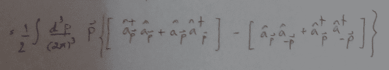

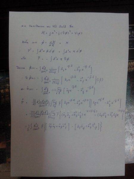

Hello, I also try to prove eq. 2.33 in page 22
by replacing phi(x) as you mentioned in
Pi=−∫d3x(π∂iϕ)
but i got struck with 4 term with a†a†, aa ,a†a, and aa†
I don't know how to go next to get rid off first 2 terms (because the last 2 terms can use the commutation relation to combine it as number operator)
How do i get rid of the "a†a† and aa" terms?
can you give the expression?
Here is the picture of my note (I wrote it in Thai but just see the equations)
you can see that the last equation has 4 terms with creation and annihilation operator
I have no idea how to eliminate a†a† and aa term I don't want to just ignore it.
sorry for adding picture instead of typing them. I am quite new for writing LATEX. Thank you
in case the pic is not clear
Yup the expression seems correct...
Try to think about the last (your problematic) terms, what would happen if [itex]p \leftrightarrow -p[/itex]
Obviously the integral of those terms should vanish :smile: (if Peskin is right)
