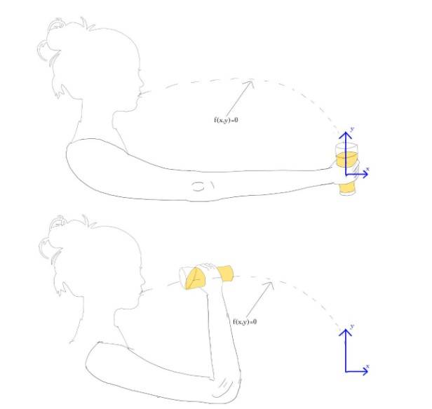

ARTISTIC BEER CHUGGING CHAMPIONSHIP
In order to win this championship, a girl has to move a beer from a defined
starting position (when her arm is stretched out) to her mouth, in a stylish manner.
To win, she needs to be majestic(have the center of gravity of the beer to follow a prescribed path, ##f(x,y)=x+30y^2=0##, w.r.t. the coord. system defined as in the figure below), speedy(move the glass to her mouth as quickly as possible) and accurate(always keep her forearm perpendicular to the path):
Initially, as shown in the first figure, she has her arms stretched out with the beer at rest.
Note that in the lower figure, not only her lower arm has moved, but also her
elbow, upper arm and shoulder have translated and rotated.
In this problem, we will limit our scope to the motion of only the lower arm,
which we will model as a simple rod with infinitesimal thickness.
Her lower arm has length of L=0.35 m , with a uniform linear density of
ρ=3.8 kg/m .
The beer (including the glass) has a mass of ##m_{beer}=0.41 kg## .
It is assumed that the beer may be idealised as a point mass.
Due to her limited muscle strength, her upper arm and elbow are only able
to exert the following reaction forces and moments on her lower arm:
-In the axial direction of the lower arm, a force of at most Sn=± 21 N
-In the direction normal to her lower arm, a force of at most St=± 39 N
-Her elbow is able to exert a moment of at most Mcr=± 4.5 N⋅m
At a certain instant in time, the beer is located at y=0.1 m and the velocity
of the beer is equal to ##v_B=5 m/s##. For this instant, compute the following:
-Magnitude of the maximum attainable tangential acceleration she is able to give to the beer
-Magnitude of the corresponding angular acceleration of the arm
-Magnitude of the corresponding reaction force that she should exert on her lower arm

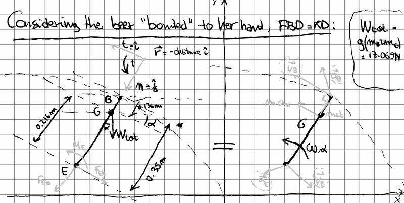

Hello guys, to analyse the above-described situation I have opted for considering the body "beer+lower arm" as a whole, therefore computing the new position of the COM for the correct FBD and equations of motion.
With some uncertainty on the statement of the problem, I have interpreted the values given for maximum ##S_n, S_t, M_{cr}## as(referring to my FBD below) the maximum attainable magnitudes of forces ##F_{En}, F_{Et}, M_E## respectively.
First, would you agree with this?

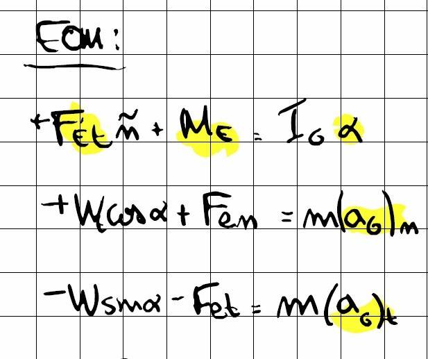

Assuming this assumption is correct and thus that the forces are those exerted by the elbow joint and muscles on the forearm, I proceeded to writing down the equations of motion for this situation:
From this we can conclude that ##F_{En}## is fixed for a certain(given, for this instant) angular velocity, being just a function of the normal CG acceleration and of the weight(I have assumed, to get to the angular velocity from ##v_B##, that the instantaneous center of zero velocity here is the radius of curvature, given our position along the path).
Using the equations of relative motion, we are able to write down:
$$\mathbf{a_t}=\mathbf{(a_G)_t+ \alpha \times r}\rightarrow \mathbf{(a_G)_t}=\mathbf{a_t-\alpha \times r}$$
(where ##\alpha## is the angular acceleration vector)which, by knowing the directions of the vectors and writing it in scalar form, enables us to substitute for ##(a_G)_t## in the EOM;
We now end up with a system of 5 unknowns(##\alpha, a_t, F_{Et}, F_{En},M_E##) in 3 equations.
Since we are aiming to maximize ##\left \| \mathbf{a_t} \right \|##, what I thought of doing was manipulating the system to write the tangential acceleration in terms of ##F_{Et}## and ##M_E##, to then seek for values of those two forces(into the range given by the problem) so that the value for the tangential acceleration would be maximized, but by doing so, I keep getting to wrong results...
What am I messing up in my analysis?
A quick comment for now... in my experience this is nearly always an unnecessary complication. Just determine the moments etc. for each component separately and add them up as appropriate.
So you mean to analyze all the FBDs separately? Because no moment will act on the hand exerted by the beer, since the latter is modeled as a particle
No, I mean e.g. that to find the MoI of the arm+beer about the elbow find each separately and add them.

I have managed to relate the acceleration of the CoG to the angular acceleration and the beer's one, is that what you mean? I got to this expression for the tangential acceleration of the beer:
$$a_t=-1.61+(0.67)F_{Et}+(5.782)M_E$$
and then this is where I got stuck
I was thrown for a while by your having used ##\alpha## for both the angle and its acceleration. Maybe change the angle to ##\theta##.
Your equations look ok, but you have not used the information about the beer's trajectory.
You don't necessarily have to get it all into one equation before differentiating.
I also arrived at this expression.
(I got 5.772 instead of 5.782, but if you only need 2 sig figs in your answer, OK.)
Maybe I'm overlooking something, but why not calculate ##a_t^{max}## by choosing appropriate values for ##F_{Et}## and ##M_E## within the given possible ranges of these quantities?
Yeah that's what I have done, trying to find the sweet spot playing with values of force and moment within the ranges, maximizing those in order to maximize the accel., but that didn't seem to work.
Can't you maximize this expression by maximizing the second and third terms separately?
Do you know what the anwser should be for ##a_t^{max}##?
greg_rack said:
being the latter just a function of the instantaneous velocity of the mass?
Ah, yes...
Unfortunately no, I don't know what the answer is... I can just know whether the final result is or is not correct
It's encouraging that we get the same result ##a_t=-1.6+0.67F_{Et}+5.8M_E##.
It seems to me that by inspection of this expression you can get the maximum value of ##a_t## by just using the maximum possible values for ##F_{Et}## and ##M_E##. Am I overlooking something?
Since they want the maximum value of the magnitude of ##a_t##, you need to consider both positive and negative values for ##a_t##. ##F_{Et}## and ##M_E## can be negative as well as positive.
Hooly cow, it's correct now!
There's no way that was the problem... with negative values it just works!
I had minded the absolute value, but still didn't think of plugging in values which would have taken me to a negative(to the right) acceleration.
