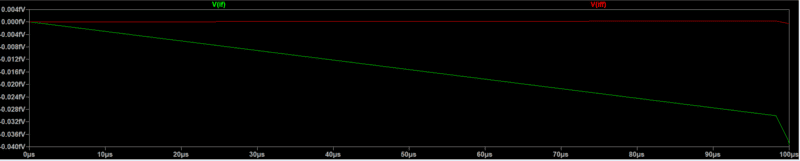

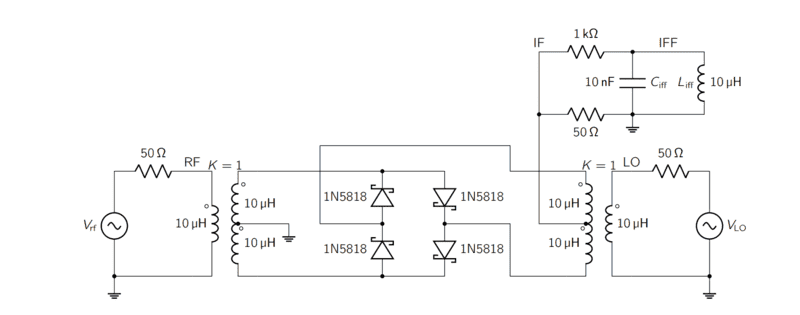

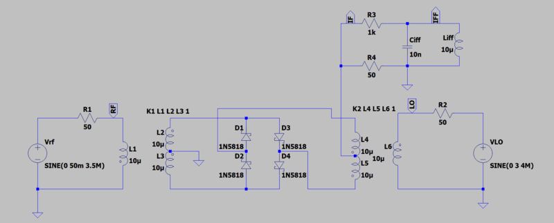

so I'm trying to design a frequency-mixer circuit. (the images are all shown below) in LTSpice, and there's a task asking me to perform a transient analysis at 100 microseconds, and find the time it takes the voltage at IFF to reach steady-state value. however, when i plotted the graph, the line (the red line in the picture) seems to be a straight line from start to finish, instead of reaching a point where the values will cease to change. is there something wrong with my schematic? or did i understand something wrong?
all the pictures in order:
1. the original schematic
2. my schematic

4. my graph ( V IFF is the red line)

LTspice requires 4 MHz to be written as 4MEG, 4meg or 4e6.
Where you use a capital M, I expect you are getting millihertz, not Megahertz.
3.5M = 3.5 millihertz. Try 3.5MEG or 3meg5

you are right! I changed it to MEG and it worked, thank you so much!
