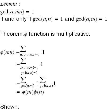

I'm trying to write a sound prove to proof that phi-function is multiplicative in the aspect of number theoretic function. Please comment on my proof. Thanks in advance.

Hi, one question,
how did you step from "the sum where gcd...m and gcd...n" to "(the sum where gcd...m) times (the sum where gcd...n)" ?
The passage from the first line to the second is not correct; the set of a's such that gcd(a,m) = 1 may not be disjoint from the gcd(a,n) = 1.
One suggestion: instead of working with the sums, try using Euler's formula for \varphi:
\varphi\left(n\right) = n\left(\ 1 - \frac{1}{p_{1}}\right)\left(\ 1 - \frac{1}{p_{2}}\right)...\left(\ 1 - \frac{1}{p_{k}}\right)
Where p_{1},...,p_{n} are the prime factors of n.

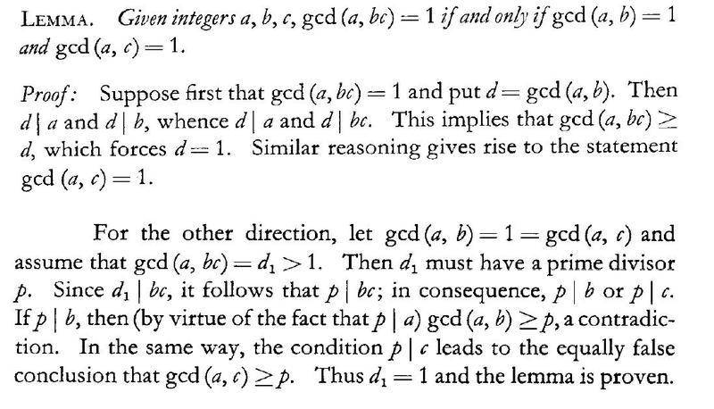

Thus, the lemma is answered , so will my proof for multiplicative function to be true?

help please (=
Nobody questioned the validity of gcd(a,mn) = 1 iff gcd(a,m) = gcd(a,n) = 1; this is true. It's simply the way you split the sums that's a bit unclear, and could be improved.
thanks ! but that split sum is valid?
