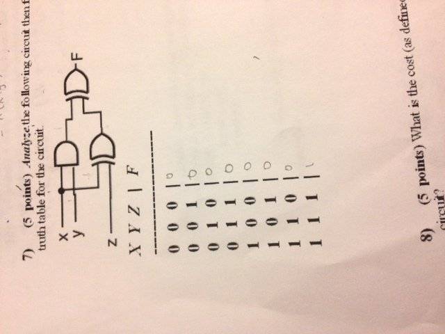

Analyze the following circuit then fill in the F column values in the truth table for the circuit.
Just need someone to check my work.
My Answer:
  • X Y Z | F
  • 0 0 0 | 0
  • 0 0 1 | 0
  • 0 1 0 | 0
  • 0 1 1 | 0
  • 1 0 0 | 0
  • 1 0 1 | 0
  • 1 1 0 | 0
  • 1 1 1 | 1
(By the way not sure why my phone is rotating all my pictures, apologies in advance).

Assuming you meant that $F=(xy) \oplus (x \oplus z),$ where the $\oplus$ symbol stands for "exclusive OR", then I get the following (building up the truth table from the beginning):
\begin{array}{c|c|c|c|c|c}
x &y &z &xy &x \oplus z &(xy) \oplus(x \oplus z)\\ \hline
0 &0 &0 &0 &0 &0 \\
0 &0 &1 &0 &1 &1 \\
0 &1 &0 &0 &0 &0 \\
0 &1 &1 &0 &1 &1 \\
1 &0 &0 &0 &1 &1 \\
1 &0 &1 &0 &0 &0 \\
1 &1 &0 &1 &1 &0 \\
1 &1 &1 &1 &0 &1
\end{array}
I'm a moron. I was evaluating xy then evaluating y ⊕ z. I see the problem now. Thanks for the help Ach!
