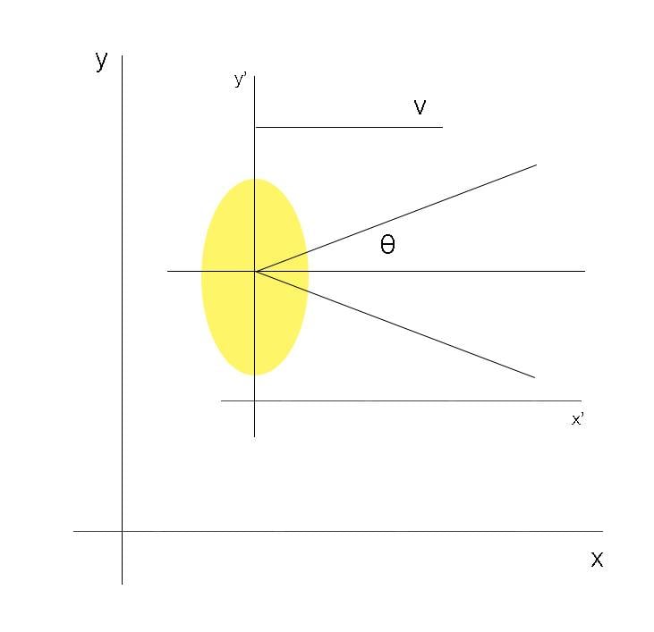

A mirror moves parallel to its plane. A beam of light hits this mirror at an angle θ. At what angle will the beam be reflected?

Before to open this topic, I found this there. It's quite similar, if not the same, but I'm a little confused, so I'm here.
The situation is represented in this image. From optical geometry, ##\theta_{incident} = \theta_{reflected}##
The four-momentum in ##S'## is the following one:
##p'^{\mu} = E'(1, -\cos{ \theta}, -\sin{ \theta}, 0)##
Now we can use Lorentz transformation in order to pass from ##S'## to ##S##.
##p^{\mu}=\Lambda^{\mu}{}_{\nu} p'^{\mu}##​

What is frame ##S## and what is frame ##S'##? What direction is the mirror moving in? What Lorentz transformation have you used - a boost in the x-direction?
##S## is the laboratory system. ##S'## is the comoving system with mirror. The mirror is moving along the x-axis. I used a boost in the x-direction.
The tricky part is the fact that "A mirror moves parallel to its plane", but in the graph drawn the mirror is moving orthogonal to its plane.
I inverted the apex on the angle that I used, it must be ##\theta'## the angle saw in ##S'## and ##\theta_i## and ##\theta_r## in the ##S## system.

Let me tell you how I think about it. In the rest frame of the mirror, we have angle of incidence equals angle of reflection: ##\theta'_i = \theta'_r##.
That means that ##u'_y## is unchanged after reflection and ##u'_x## changes sign.
Note that if ##u'_y## is constant in this frame, then ##u_y## is constant in every frame (as long as the frames agree on the y-direction).
First, let's consider the case where the mirror moves in the y-direction. In this case, the sign of ##u_x## must change on reflection. You can check this by looking at the velocity transformation formula, but it must be true by thinking about the symmetry of motion in the ##\pm x## directions in this case.
Therefore, in this case, we have ##\theta_i = \theta_r##. And that makes sense physically as the mirror moving in the y-direction does not affect the reflection process.
Now, can you analyse the case where the mirror is moving in the x-direction - towards the light source?

What are your conclusions? I want to know whether ##\theta_i = \theta_r## or not. I want a straight answer: yes or no, and why.
No, it's not equal.
In ##S'## we have:
##u_{ix}' = -\cos \theta_i'##
##u_{rx}' = \cos \theta_r'##
In ##S## we have:
##u_{ix} = -\cos \theta_i = \frac{-\cos \theta_i' + v}{1-v\cos \theta_i'}##
##u_{rx} = \cos \theta_r = \frac{\cos \theta_r' + v}{1+v\cos \theta_r'} = \frac{\cos \theta_i' + v}{1+v\cos \theta_i'}##
The last step come from the fact that in ##S'## we have ## \theta_r' = \theta_i'##.
The value of ##|u_{ix}|\neq |u_{rx}|## as it was with ##|u_{ix}'|= |u_{rx}'|##

I wrote all the passages that I have done:
In ##S'##, we have ##\theta_i'=\theta_r'##
For the beam incident we have:
##u_{ix}'=-\cos \theta_i'##
##u_{iy}'=-\sin \theta_i'##
For the beam reflected we have:
##u_{rx}'=\cos \theta_r'##
##u_{ry}'=-\sin \theta_r'##
In ##S## we have:
##u_{ix}=-\cos \theta_i = \frac{-\cos \theta_i'+v}{1-v\cos\theta_i'}##
##u_{iy}=-\sin \theta_i =\frac{-\gamma \sin \theta_i'}{1-v\cos\theta_i'}##
##u_{rx}=\cos \theta_r = \frac{\cos \theta_r'+v}{1+v\cos\theta_r'}##
##u_{ry}=-\sin \theta_r =\frac{-\gamma \sin \theta_r'}{1+v\cos\theta_r'}##
Now let's calculate:
##\frac{u_{iy}}{u_{ix}}=\tan\theta_i=\frac{\gamma \sin \theta_i'}{\cos \theta_i'-v}##
##\frac{u_{ry}}{u_{rx}}=\tan\theta_r=\frac{\gamma \sin \theta_r'}{\cos \theta_r'+v}##
##\frac{\tan\theta_i}{\tan\theta_r}=\frac{\gamma \sin \theta_i'}{\cos \theta_i'-v}\frac{\cos \theta_r'+v}{\gamma \sin \theta_r'}##
Remembering that ##\theta_i'=\theta_r'## we have:
##\frac{\tan\theta_i}{\tan\theta_r}=\frac{\cos \theta_r'+v}{\cos \theta_r'-v}##
Using the inverse Lorentz transformation we have:
## \cos \theta_r' = \frac{\cos \theta_r - v}{1-v\cos\theta_r}##
Substituting this in the relationship between the tangents we have:
##\frac{\tan\theta_i}{\tan\theta_r}=\frac{\cos \theta_r (1-v^2)}{\cos\theta_r(1+v^2)-2v} \implies \tan\theta_i = \frac{\cos \theta_r (1-v^2)}{\cos\theta_r(1+v^2)-2v}\tan\theta_r##
This shows that ##\theta_r \neq \theta_i## in ##S##.
Could it be ok now? Or I missed again something? Or have I made a mistake in the starting hypotheses?
I'll look at it later if I have time. You can simplify that last expression to ##\frac{1 + v}{1-v}##.
