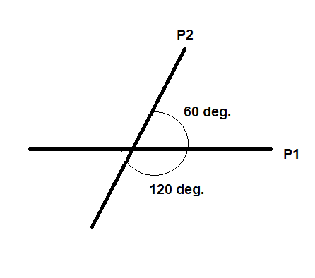

Here's a simple example, given the equations of two planes in ##\mathbb R^4##.
##P_1: x + y + z + w = 2##
##P_2: x - y + z + w = 6##
The normals and their magnitudes:
##\vec N_1 = <1, 1, 1, 1>##
##\vec N_2 = <1, -1, 1, 1>##
##| \vec N_1| = \sqrt{1^2 + 1^2 + 1^2 + 1^2} = \sqrt 4 = 2##
##| \vec N_2| = \sqrt{1^2 + (-1)^2 + 1^2 + 1^2} = \sqrt 4 = 2##
Cosine def. of the dot product (rearranged):
##\cos(\theta) = \frac{\vec N_1 \cdot \vec N_2}{|\vec N_1| |\vec N_2 |}##
##= \frac{2 } { 2 \cdot 2} = \frac 1 2##
##\cos(\theta) = \frac 1 2 \Rightarrow \theta = \frac \pi 3## or 60°
The main difference between what I did and what the stackexchange answer described was that my normals aren't of unit length.
Here's a simple drawing of the two planes of my example, looking straight down the line of intersection of the planes. One of the points of intersection is (1, -2, 1, 2). Another is (2, -2, 1, 1).
