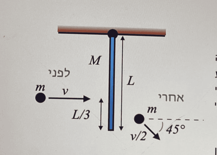

a bullet hits a rod attached to a ceiling with a velocity v and then gets out with velocity v/2 ,
how much momentum went from rod to ceiling, and how much initial energy got lost ,
Li=Lf
Diagram of a bullet of mass m with speed v striking a uniform rod of mass M and length L hinged at its top to a ceiling, at a point L/3 above its bottom; after impact the bullet moves at v/2 at 45 degrees below the horizontal.
I went and checked is energy conserved the answer is no since the bullet velocity is not the same as it was initially ,
I am not sure how to check Linear momentum conservation and angular momentum conservation , at first I assumed that the system linear momentum would be conserved during collision to say the assuming that what the bullet lost is gained by the rod I think I know now why that's not the case it is possibly because the rod is attached can't go up or down nor right or left so it will gain angular momentum but whatever linear momentum is there it would go to the ceiling?
if it was not attached though falling from the sky and the bullet hit it would the momentum be conserved during collision?
as for angular momentum being conserved I can understand that in the initial states the torque is zero on the rod and on the bullet ,so the angular momentum is conserved before or after , but then when I look at the rod after it changed location so that angle is not zero with the axis of rotation there is an torque on it , so I get confused regarding angular momentum Conservation
should I consider them as 2 different situations such that if I throw a bullet after it moved the angular momentum is not conserved but now for the first situation it is conserved

The rod is connected to the ceiling, which may apply a force with a horizontal and vertical components to the system. So, again you cannot assume that linear momentum is conserved.

I think you are confused about angular momentum. The system has angular momentum about the pivot point, where the rod is attached to the ceiling. Note that the bullet's linear momentum also represents angular momentum about any point not on its initial line of motion. The bullet has initial angular momentum about the pivot point.

The gravitational force on the bullet is ignored, because the collision happens very quickly and gravity would only have a small (negligible) affect on the collision.

The thing you are missing is that that angular momentum about the pivot point is conserved. This is because the force at the pivot point applies to torque about that point.
That's the key to these questions.

Imagine that the rod was only very loosely connected to the ceiling when it gets hit by a bullet! What would happen? The rod would get ripped out of position and probably go flying off to the right somewhere.
If that doesn't happen, then you know that there must have been a significant force at the pivot point to hold the rod in place. It's not necessary to calculate that force. But, you know that the linear momentum of the system is not conserved.

This problem analyses a collision that takes place over a short time, where gravity has no time to act significantly.

After the collision, gravity will act through the centre of mass and the rod will swing back and forward as you would expect. But, that's beyond the time of the initial analysis.

Angular momentum of a system is conserved when the net torque on the system is zero. You should be able to find a statement like this in the textbook section on conservation of angular momentum.
