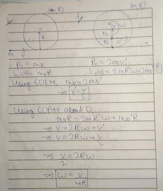

Also, here is my new procedure.
Please use the forum LaTeX features rather than posting images. Images are impossible to quote relevant parts of.
I do not understand what you have done to write down the angular momentum conservation. The correct procedure is in #23.

I think you have confused yourself by, on the one hand, taking moments about O and, on the other, defining v' as the velocity of the CoM.
For clarity, I will refer to the original position of the centre of the hoop as the fixed point O and the moving centre as O'.
Since, for angular momentum purposes, you are treating the subsequent motion of the bullet as the sum of rotation about O' and the linear motion of O', and you have already accounted for the rotational contribution of the bullet about O' in ##2mr\omega^2##, you just need the contribution from the bullet in respect of the linear motion of O'.
What is the velocity of O'?
I do not get this part.
How do we find that out?
Calculate it from v', r and ω. Call it v".
For the purpose of finding the angular momentum about O, you can think of the motion of the hoop+bullet system immediately after impact as the sum of the linear motion of O' (velocity v") and a rotation about O'. For each of hoop and bullet, each of these motions makes a contribution to the angular momentum, potentially making four terms in all.
For the hoop, the linear motion of the mass centre is in a line through O, so that term is zero. The rotational term is ##mr^2\omega##.
The rotational term for the bullet is also ##mr^2\omega##, as you posted.
That leaves the linear term for the bullet: a mass m moving at velocity v" along a path that is distance r from O at the nearest: ##mv''r##
