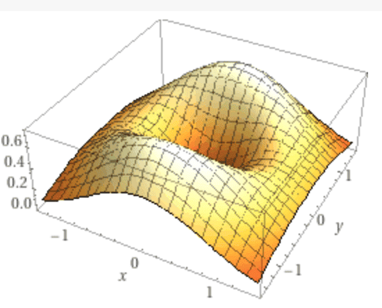

Addez123 said:
What be the reason for asking?
I was wondering if I would do much harm if I showed you a kind of cheat:
On Wolframalpa you can enter the function expression :
(x^2+2y^2)exp(-(x^2+y^2))​
and it gives you a 3d plot and a contour plot of the function plus expressions for x and y derivatives, as well as a list of extrema
((x^2+2y^2)exp(-(x^2+y^2)))' gives you a 3d and a contour plot of the x derivative
d/dy ((x^2+2y^2)exp(-(x^2+y^2))) gives you a 3d and a contour plot of the y derivative
Nifty tool ! Didn't have that when I was in 3rd year, half a century ago :biggrin:
Hahah, I've been using that since day one xD
The answers are always in your book though. But yeah, wolfram is useful!
