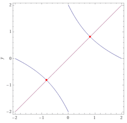

The 3rd exercise is find the closest point on the curve ##x^2 + 4xy+y^2 = 4## to (0,0).
It could probably be solved by simply minimizing the distance function ##d = \sqrt{x^2+y^2}## as a single variable function, but obviously I am suppose to solve it using lagrange multiplier or that determinant version.
I looked it up on youtube where he solves exactly that issue using lagrange, he also ends up with an unsolveable mess and recommends you plug the numbers into a computer to get your results.
Starting to wonder what kind of hidden witchcraft this book is trying to teach me lol
Addez123 said:
They are all like this :(
Great !
That's a piece of cake now ! Rotate 45 degrees :oldlaugh: and see a hyperbola equation. Therefore
Graph of two blue hyperbola branches in the x-y plane with a straight red line through the origin at 45 degrees, meeting them at two red-dotted points near (-0.8, -0.8) and (0.8, 0.8).
Almost absolutely right ! ##d = \sqrt{x^2+y^2}## is a two variable function to be minimized under the constraint ##x^2 + 4xy+y^2 = 4##. But why make things difficult if you can also minimize ##f = {x^2+y^2}## ? In which case the unsolveable mess isn't all that messy. You want to give it a try, now that you know the answer ?
goes to show you can't trust the internet
My two cents: good use of a proper set of brain cells. Not magic, no witchcraft, but definitely something beyond reach for a tremendous amount of folks :smile:
