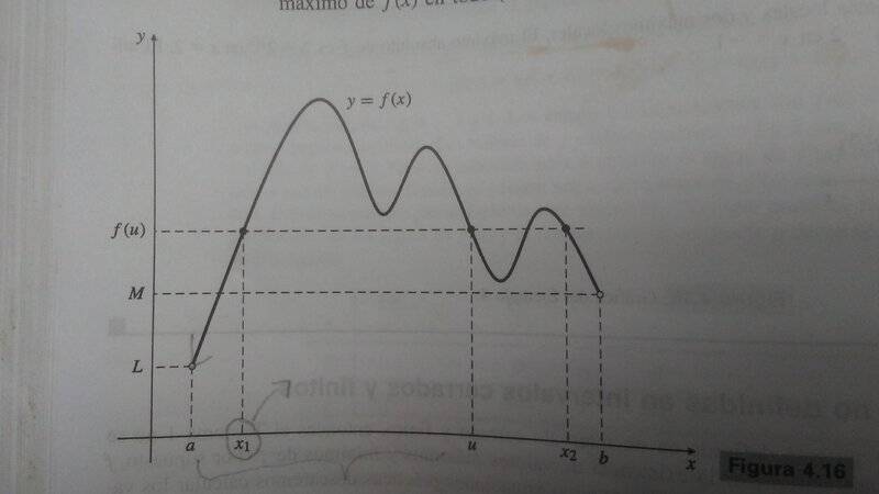

Hello, PF
This is Theorem of "Existence of extreme values on open intervals". I have an alternative and easier proof, based on epsilon-delta arguments, but it's not mine, and I don't understand it completely.
I quote the theorem:
If ##f## is continuous on the open interval ##(a,b)##, and if
##\displaystyle\lim_{x \to{a^{+}}}{f(x)}=L\quad{\mbox{and}}\quad{\displaystyle\lim_{x \to{b^{-}}}{f(x)}=M}##
Then the following conclusions hold:
(i) If ##f(u)>L## and ##f(u)>M## for some ##u## in ##(a,b)##, then ##f## has an absolute maximum value on ##(a,b)##
(ii) If ##f(v)<L## and ##f(v)<M## for some ##v## in ##(a,b)##, then ##f## has an absolute minimum value on ##(a,b)##
In this theorem ##a## may be ##-\infty##, in which case ##\lim_{x \to{a^{+}}}{}## should be replaced with ##\lim_{x \to{{-\infty}}}{}##, and ##b## may be ##\infty##, in which case ##\lim_{x \to{\infty}}{}##.
Also, either or both ##L## and ##M## may be either ##\infty## or ##-\infty##
PROOF We prove part (i); the proof of (ii) is similar. We are given that there is a number ##u## in ##(a,b)## such that ##f(u)>L## and ##f(u)>M##. Here ##L## and ##M## may be finite numbers or ##-\infty##. Since ##\lim_{x \to{a+}}{f(x)}=L## there must exist a number ##x_1## in ##(a,u)## such that
##f(x)<f(u)## whenever ##a<x<x_1##
Similarly, there must exist a number ##x_2## in ##(u,b)## such that
##f(x)<f(u)## whenever ##x_2<x<b##
(See attached Figure)
Thus, ##f(x)<f(u)## at all points of ##(a,b)## that are not in the closed, finite subinterval ##[x_1,x_2]##. By Theorem of Existence of extreme values, the function ##f##, being continuous on ##[x_1,x_2]##, must have an absolute maximum value on that interval, say at the point ##w##. Since ##u## belongs to ##[x_1,x_2]##, we must have ##f(w)\geq{f(u)}##, so ##f(w)## is the maximum value of ##f(x)## for all of ##(a,b)##.
And this is the reply
"Actually what's in the book I don't see very well. Focusing on doubt, if definition of limit is simply applied appropriately for ##a,b\in{R}## i.e. for real numbers:
##\exists{\epsilon} \ / \ 0<\epsilon<f(u)-L##. Definition of limit implies ##\exists{\delta}>0 \ / \ if \ x\in{(a,a+\delta)}\Rightarrow{\left |{f(x)-L}\right |\epsilon}\Rightarrow{f(x)<L+\epsilon<f(u)}##
Similarly,
##\exists{\epsilon'} \ / \ 0<\epsilon'<f(u)-M## , definition of limit implies ##\exists{\delta'}>0 \ / \ if \ x\in{(b-\delta',b)}\Rightarrow{\left |{f(x)-M}\right |<\epsilon'}\Rightarrow{f(x)<M+\epsilon'<f(u)}##
Specifically, for your doubts you can take ##x_1=a+\delta \wedge x_2=b-\delta'##
Therefore it is known that exists the maximum of ##f## in the interval ##[a+\delta,b-\delta']##. And I think you can continue"
Question:
Let's place the function in the first quadrant, for simplifying the matter:
Why does ##\exists{\epsilon} \ / \ 0<\epsilon<f(u)-L##?. Similarly, why does ##\exists{\epsilon'} \ / \ 0<\epsilon'<f(u)-M##?
1-Limits exist. Therefore exist ##\forall{\epsilon>0}##.
2-##f(u)-L##, as well as ##f(u)-M##, are fixed numbers.
3-Therefore, I can state
##\exists{\;0<\epsilon<f(u)-L}##, or ##\exists{0<f(u)-L<\epsilon}##. Similarly with ##\epsilon'##
Greetings! If this is a mess, or am I overthinking, ignore. Thanks, love.
P.S. Don't know if done right the LaTeX

That is not an alternative proof of the theorem, it is a proof of the statement
mcastillo356 said:
Since ##\lim_{x \to{a+}}{f(x)}=L## there must exist a number ##x_1## in ##(a,u)## such that ##f(x)<f(u)## whenever ##a<x<x_1##
which appears as part of the proof in the book. I am not sure why the poster in the Spanish forum felt that expanding this part of the proof was needed, the statement in Adams' proof appears trivially true to me, and in case you don't see this Figure 4.16 provides a clear visualisation.
You are definitely overthinking. You have provided an expanded proof of a trivial statement which is itself part of an expanded proof of a trivial statement which is part of a proof in Adams' book.
If there is an assumption or a step in an author's proof that you don't understand then of course you should go back and think it through (in this case by reference to Figure 4.16), and of course it is always possible that your end-of-course assessment may ask you to prove such a step.
However if you are going to learn anything from a book at some point you need to rise above this focus on the trivial.
