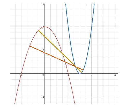

The other day a friend of mine gave me the above problem which I found rather interesting. I was able to get a numerical solution. I'll post how I solved it later in the thread. Others may want to try it and see what they come up with.
Square of the distance is
$$L^2=(y_1-y_2)^2+(x_1-x_2)^2=(4-x_1^2-(x_2-3)^2)^2+(x_1-x_2)^2$$
The condition of minimum is
$$\frac{\partial L^2}{\partial x_1}=\frac{\partial L^2}{\partial x_2}=0$$
Intersection of these two curves would give an answer.
@anuttarasammyak That's one part of what I did to solve it. Those two partial derivative expressions are really too clumsy to solve exactly. I used them though by getting an approximate ## x ## for where the two ## x ## values occur by first solving for the ## x ## where the vertical distance is a minimum. That turns out to be at ## x=3/2 ##.
I then let ## x_1=3/2+ \Delta_1 ## and ## x_2=3/2+ \Delta_2 ## and solved for ## \Delta_ 1## and ## \Delta_2 ## to first order using the two partial derivative expressions.
Others may want to try the calculation and/or have alternative ways of solving it, so I'm leaving just a summary of the solution rather than showing all of the details.

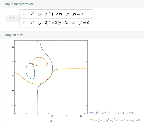

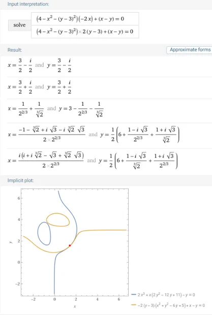

With the help of Wolfram I get one real solution. https://www.wolframalpha.com/input?i=Solve+(4-x^2-(y-3)^2)(-2x)+(x-y)=0+and++(4-x^2-(y-3)^2)2(y-3))+(x-y)=0.+
Wolfram Alpha output: two solve results listing complex and real solutions for x and y, followed by an implicit plot of two curves in blue and orange with a red point marking the near-intersection, axes labelled x and y.
where ##x=x_1,y=x_2## Let us confirm it.
It is easily observed that the two curve formula coincide when ##-x=y-3=-a## thus a should satisfy
$$4a^3-6a-3=0$$
which derives all the solutions. Using real ##a=2^{-1/3}+2^{-2/3}=1.42366...##.
The minimum distance is
$$L=\sqrt{4a^4-12a^2-12a+25}=\sqrt{-6a^2-9a+25}=\sqrt{19-12*2^{-1/3}-15*2^{-2/3}}=0.16182....$$
when ##x_1=a, x_2=3-a##
I hope I commit no more careless mistakes.

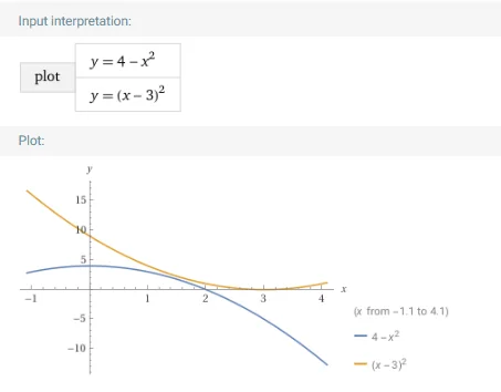

Wolfram Alpha plot of y = 4 - x^2 (blue) and y = (x - 3)^2 (orange) for x from -1.1 to 4.1, with the curves crossing near x = 2 and the orange curve reaching its minimum at x = 3.
  • Implicit plot of two curves on x and y axes from -3 to 6: a blue curve with a loop near the left and a tail descending to the bottom, and an orange curve with a small loop above and a horizontal tail to the right, with a red dot where they nearly meet.

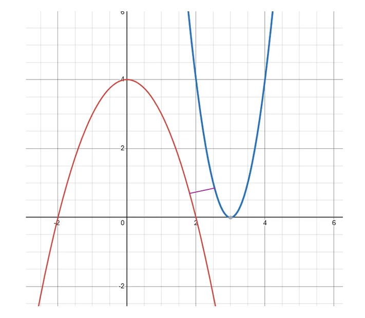

Let ## (x_1,y_1) ## be a point on the curve ## f(x)=4-x^2 ##, which is the closest point on the curve ## f(x) ## to the curve ## g(x)=(x-3)^2 ##, and let ## (x_1+a,y_1+b) ## be a point on the curve ## g(x)=(x-3)^2 ##, which is the closest point on the curve ## g(x) ## to the curve ## f(x) ##. That means that curves ## y-b=4-(x-a)^2 ## and ## y=(x-3)^2 ## intersect at only one point. The equation ## b+4-(x-a)^2=(x-3)^2 ## has only one solution, and its discriminant must be equal to zero. There is ## 2b+6a-a^2-1=0 ##.
The slope of ## y=4-x^2 ## in point ## (x_1,y_1) ## is ## -2x_1 ## and it is equal to ## -a/b ##. Also, it is equal to the slope of ## y=(x-3)^2 ## in point ## (x_1+a,y_1+b) ##, and we have ## -2x_1=2(x_1+a-3) ##. From ## -2x_1=-a/b ## and ## -2x_1=2(x_1+a-3) ## we have ## b=a/(3-a) ##.
After substituting ## b ## with ## a/(3-a) ##, the equation ## 2b+6a-a^2-1=0 ## will be ## a^3-9a^2+21a-3=0 ##. I can solve the equation ## a^3-9a^2+21a-3=0 ## without using a computer, only numerically. The computer gives me the result of ## a=0,15267789 ##. ## b=a/(3-a) ## implies that ## b=0,05362157 ##.
The minimum distance is ## \sqrt{a^2+b^2}=0,16182031 ##.
@Gavran Very good=Excellent. :)
You have an interesting approach where you translated the first curve by ## (a,b) ## until it made contact with the second curve at ## (x_1+a,y_1+b) ##. (To get this to occur you set the discriminant to zero=very clever).
I checked over your calculations, and you are also in complete agreement with @anuttarasammyak , @pasmith , and Wolfram. You get ## a^3-9a^2+21a-3=0 ##, but your ## a=3-2x_1 ##. With that substitution, we once again have ## 4x_1^3-6x_1-3=0 ## as first mentioned by @anuttarasammyak in post 4.
Good work and thank you. <3 <3

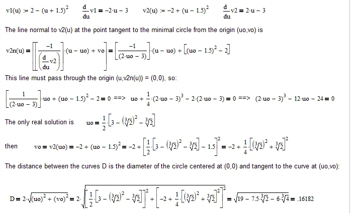

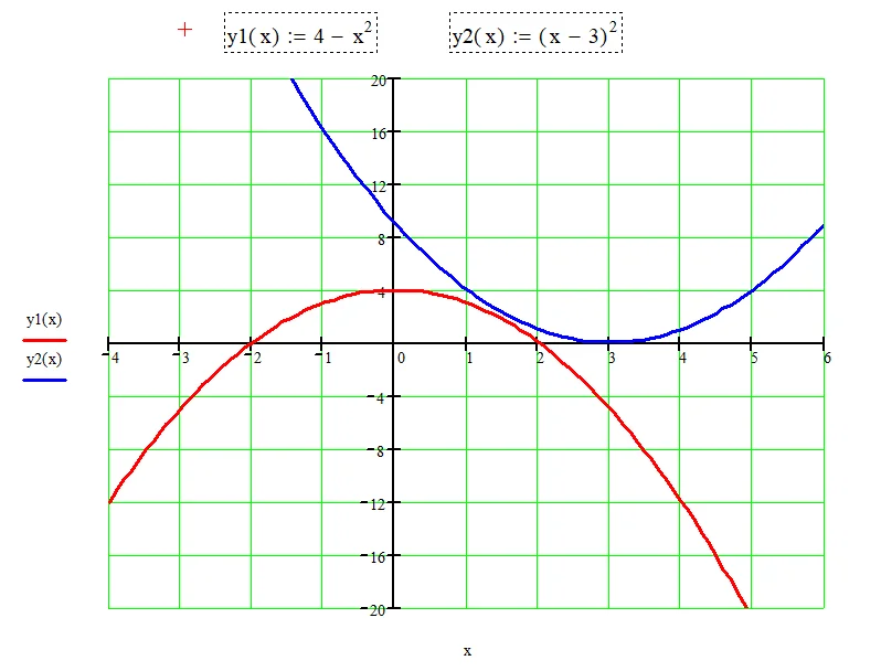

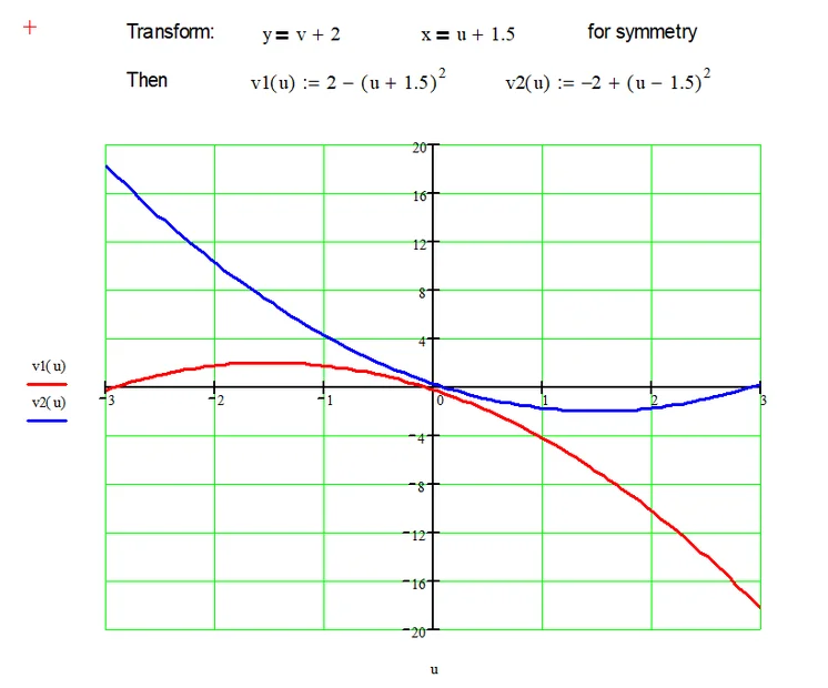

My approach relied on symmetry and geometrical reasoning with just a tiny bit of calculus.
Since these two curves are translated and inverted versions of each other, I used a shifting transform to locate the origin at the midpoint between the maximum and minimum points on each curve. Because the transform is only shifting the curves, the spacing isn't changed, so there will be no need to invert the transform.
Graph of y1(x) = 4 - x^2 in red, an inverted parabola with vertex at (0, 4), and y2(x) = (x - 3)^2 in blue, an upward parabola with vertex at (3, 0), on a green grid with x from -4 to 6 and y from -20 to 20.
Graph of two parabolic curves v1(u) and v2(u) plotted against u from -3 to 3, with v1 in red and v2 in blue; v1 peaks near u = -1.5 and v2 dips near u = 1.5, and the curves are mirror images about the origin.
Because these curves are now symmetric about the origin, the minimum distance line segment must pass through the origin. It must also be normal to the curve surfaces. A circle centered at the origin and tangent to each curve will have a diameter equal to the minimum spacing. So if we locate the normal line from one curve that passes through the origin we can find the tangent point which will be the radius of that circle and half of the minimum spacing.
Handwritten-style algebra worksheet from a Mathcad-type document: derivation of the minimum distance between two parabolic curves v1(u) and v2(u), ending with D = 2·sqrt(uo² + vo²) ≈ 0.16182.
Edit: There's a sign error in the last cubic equation. It should be
##(2*uo-3)^3 - 12*uo + 24 = 0## ⇒ ##(2*uo-3)^3 - 6*(2*uo-3) + 6 = 0##
But the solution is still correct from there on.
@DaveE Excellent. In hindsight, your solution where you pointed out the inverted and translated symmetry of the two essentially identical parabolas is almost obvious, but I failed to recognize it. Thank you very much for your input. <3 <3
and your solution is in complete agreement with previous solutions by @anuttarasammyak , @pasmith , and @Gavran , and fundamentally very elegant. :)

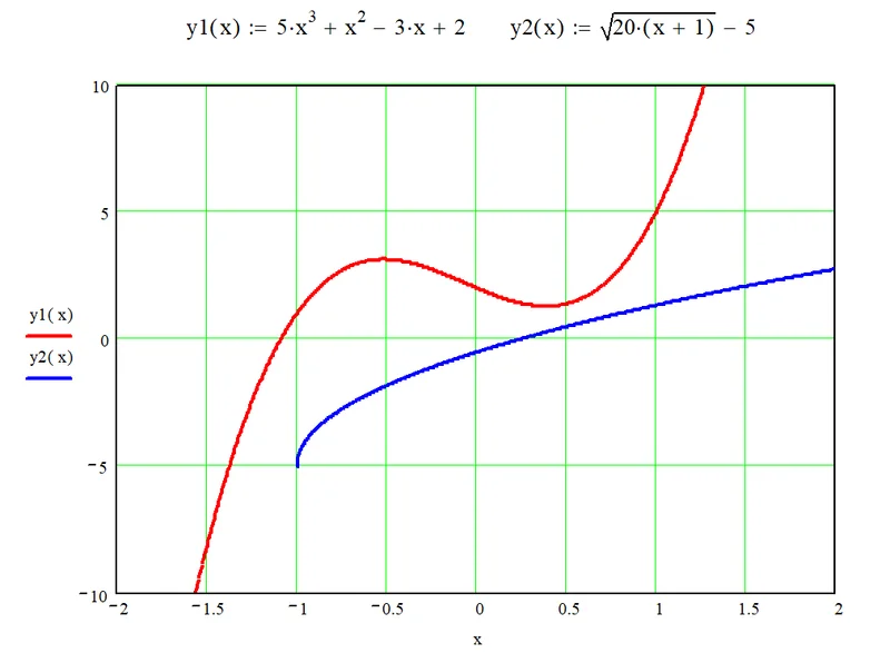

Find the two points that share the same normal line. It would be a general way as @pasmith showed.
Yes, as long as they exist and are unique. Otherwise you will also have to find the best one, like other min/max problems.
Graph of y1(x) = 5x^3 + x^2 - 3x + 2 in red and y2(x) = sqrt(20(x + 1)) - 5 in blue over x from -2 to 2, y from -10 to 10.
There's also y(x) = |x| & y(x) = -1, where you have to check the endpoints and such.
Yes, after we check that the curves do not cross at first.

Graph of a downward red parabola with vertex at (0, 4) crossing the x-axis at x = -2 and x = 2, and an upward blue parabola with vertex at (3, 0), with a short purple segment joining the two curves.

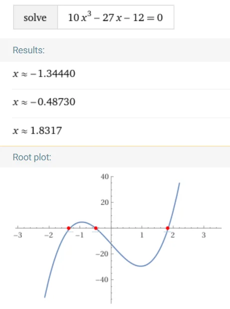

I got ##x_1=1.8317... \ x_2=3-\frac{x_1}{4}=2.5421...## The equation of ##x_1##:
Screenshot of a cubic equation solver showing solve 10x^3 - 27x - 12 = 0, with results x ≈ -1.34440, x ≈ -0.48730, x ≈ 1.8317, and a root plot of the cubic curve crossing the x-axis at three red-marked points.
Other two casese :
##(x_1.x_2)=(-1.3444, 3.3660),(-0.48370, 3.1215)##
