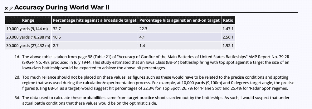

Dale said:
How about the big guns on a large naval battleship?
source: http://navweaps.com/Weapons/WNUS_16-50_mk7.php
Another thing you can teach, you have to compensate for the Coriolis force (rotation of the Earth) when aiming at these ranges. At least you would, today, to achieve modern accuracy numbers.
