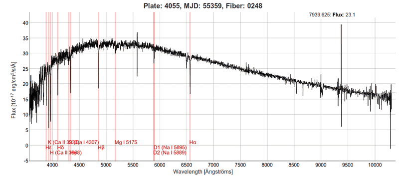

There's a wealth of spectral data on stars, galaxies and quasars available at the SDSS website at http://mirror.sdss3.org/ I attached an image of the type of spectrum you can get. It will take a little bit of learning to learn how to find the spectra (they are under "Optical Spectra"), but it is well worth it. At SDSS, they run a preliminary imaging run, then select which objects they want spectra on, and then take the spectra. SDSS is able to get spectra on about 500-1000 objects at a time for each exposure.

Thats cool! but this data contains only the total light of the entire object, right? So you can't see an image made of different wavelengths

A spectrum is a plot where the light is broken up into different wavelengths. The plot I uploaded shows the light intensity on the Y-axis vs wavelength on the X-axis.
To be overly explicit, a spectrum is exactly an image of the different wavelenghts from some source. It does however not make a picture in the sense that you have any spatial information.

Right. If you want images at different wavelengths, the SDSS site has 5 different images taken through 5 different filters, called ugriz. You can download the fits files for these images.
