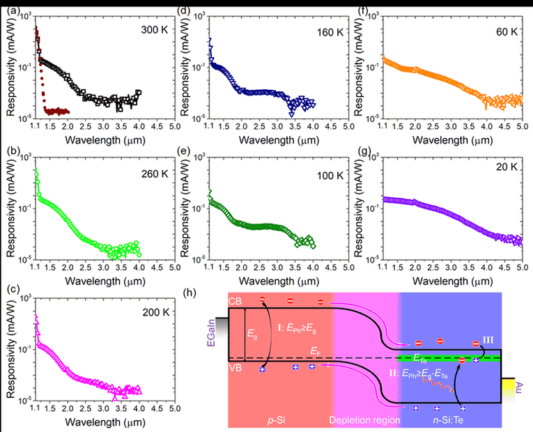

This started as an astrophotography question and morphed into a thermodynamics question & it was suggested to start a new thread in Thermodynamics.
Essentially the question is how do I reconcile the behavior of particular infrared photodetectors with the 2nd Law of Thermodynamics?
For example suppose I take a well-insulated tank of room temperature (300k) water and lower in a PN junction HgCdTe infrared photodetector (also at room temperature, 300k) operating in Photovoltaic mode with zero applied bias voltage. Water at 300k has a black body spectrum which includes the emission of 3.5 micrometer infrared light. IR detectors made from HgCdTe (operating at 300k) in the paper linked to below exhibit "current responsivity" when absorbing infrared radiation, also at 3.5 micrometers (with 0v applied bias voltage).
If I can generate any current from the black body radiation of room temperature water with an HgCdTe IR detector, also operating at 300k with 0v bias voltage, how do I reconcile it with the 2nd Law of Thermodynamics? I thought I shouldn't be able to produce any useful work from a heat reservoir which initially has no temperature gradient.
https://www.researchgate.net/publication/343856156_Higher_Operating_Temperature_IR_Detectors_of_the_MOCVD_Grown_HgCdTe_Heterostructures
https://www.speakev.com/cdn-cgi/image/format=auto,onerror=redirect,width=1920,height=1920,fit=scale-down/https://www.speakev.com/attachments/5000b9e5-011d-4ef0-af59-bedb15ff822e-jpeg.156575/
https://www.speakev.com/cdn-cgi/image/format=auto,onerror=redirect,width=1920,height=1920,fit=scale-down/https://www.speakev.com/attachments/94567243-aafc-4537-af56-e65cc0fd1755-jpeg.156576/

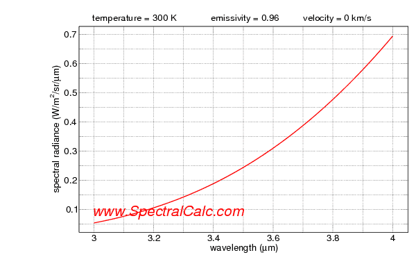

Black body spectrum of room temperature (300k) water:
https://www.speakev.com/cdn-cgi/image/format=auto,onerror=redirect,width=1920,height=1920,fit=scale-down/https://www.speakev.com/attachments/aea0d9fd-14b5-4308-a81c-f5fb6ef06d83-png.156577/

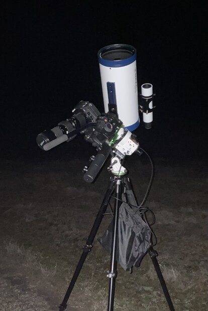

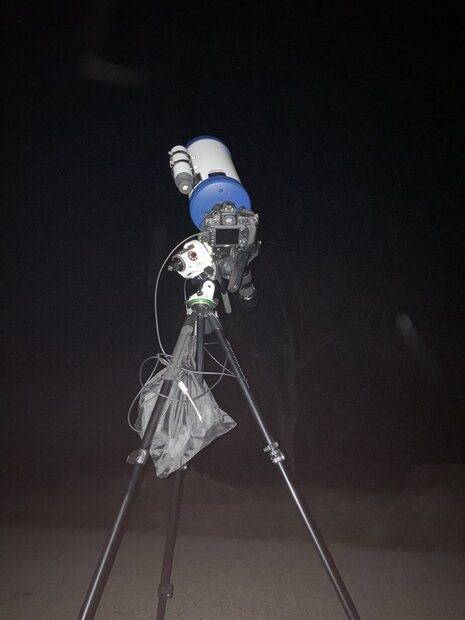

Core of Andromeda Galaxy, 2.5Mly
2130mm f/14.2 29x 90sec (43.5min) 6400iso, Bortle 2
It’s been a while since I’ve taken any astro-photos (its been cold, cloudy and rainy for quite a long time.) I managed to find a break in the clouds last night while the moon was down and captured this photo of the core of Andromeda Galaxy, which is around 2.5 million light years distant. I shot using a 150mm diameter Meade Maksutov Cassegrain on a Star Adventurer 2i mount with some modifications to go probably 3x over the weight limit with a Nikon D800 camera body. I aimed the telescope by taking test shots and plate solving through a website on my phone and then making adjustments. I used the 29 best images although I think I got around 60 total, only about half had round enough stars with 90 second exposures at this focal length on this mount. My bortle 2 dark sky location is near Shingletown, California.

Could you comment on the graph on this webpage… I might be misinterpreting it but I believe graph (a) shows a particular detector which is at 300k (~80F) operating temperature generating current from mid-infrared light up to 4000 nanometers with zero bias, which I take to mean the detector is operating in photovoltaic mode with no outside voltage applied…
https://www.researchgate.net/figure/a-g-The-spectral-responsivity-measured-at-zero-bias-ie-photovoltaic-mode-for-the_fig3_346511011View attachment 296153
“(a)-(g) The spectral responsivity measured at zero bias (i.e. photovoltaic mode) for the Te-hyperdoped Si photodetector at different temperatures. The room-temperature spectral responsivity of a commercial Si-PIN photodiode (model: BPW34) is included as a reference (brown short dot). (h) Illustration of the below-bandgap photoresponse in the Te-hyperdoped Si photodetector. Te dopants introduce deep-level states (intermediate band) inside the Si band gap, which facilitate the absorption of photons with sub-bandgap energies. Process I: VB to CB (Eph ≥ Eg); Process II: VB to IB (Eph ≥ Eg-ETe); Process III: IB to CB (Eph ≥ ETe, only measurable at low temperatures where the thermal contribution is neglected).”
Drakkith said:
Not really. I'm not an expert in the area of photodetectors and solid state physics and such. I'll try to remember to give it a read tomorrow or the next day if I can, but I might not have time.
Drakkith said:
Quickly skimmed through the article just now. I come to the same conclusion as you.
Note that at 300K an object barely emits any radiation in the 1-5 micrometer range. You have to get warmer for that. You can use the calculator here to see the spectrum emitted by an object at a given temperature. Use 1 micrometer as the upper limit and 5, 10, or 20 as the lower limit to get a good looking graph of the region of interest.

Thanks for the calculator! According to its output, with inputs for the emissivity of water (0.96) at 300k (~80F), ordinary room temperature water is emitting some blackbody infrared radiation from 3-4 micrometers— at wavelengths the “Te-hyperdoped Si photodetector” also @ 300k can generate current from in photovoltaic mode… I must be missing something because why couldn’t I just generate a small amount of electricity by submerging these room temperature photodetectors in room temperature water to harvest the 3-4 micrometer infrared black body radiation photons by photovoltaic means? Wouldn’t that conflict with the 2nd Law of Thermodynamics? I shouldn’t be able to generate any useful work from a single temperature reservoir, was my understanding.
Drakkith said:
That I can't answer. I'm certain the 2nd law isn't being violated, but I couldn't tell you how or why it isn't.

Maybe I'm missing something myself. But It's my understanding that you couldn't generate any electricity by simply submerging the photodetector in water because there wouldn't be a light source in that situation.
It's my understanding of the test setup that the photodetector is placed and held at a given temperature, then it is exposed to a light source of a specific wavelength and specific intensity (with a proportional power reaching the detector, measured in Watts) and the current of the photodetector is measured (measured in milliamps). That is used to generate a single point on a single graph. For any given situation (wavelength of the light source and temperature of the photodetector), the current of the photodetector is proportional to the power of the light source. Which is why the measurements are in units of mA/W.
At least that's my understanding. The power is ultimately coming from the light source. The 2nd Law is not violated. The current vanishes as soon as you turn off the light.
Devin-M said:
A 300k (80F) black body emits some infrared between 3 & 4 micrometers, which is in the detection range of the photodetector.

collinsmark said:
Yes, but the photodetector is also emitting infrared too -- the same amount that it receives when its own temperature is at 300 K, along with everything else in the surroundings being at 300 K, and when no external light source is present. Without the presence of the external light source the net current is zero. At least that's my understanding.
I don't know the test setup, but here's how I imagine it:
A broadband blackbody radiation source is involved; an incandescent bulb will do. The light from the source passes through a slit followed by a diffraction grating, thus splitting up the light (including infrared light) into a spectrum. The intensity along the spectrum is measured and calibrated (perhaps with a small, calorimeter device). With this information, the light intensity along specific wavelengths of the spectrum is known.
The photodetector can then be placed along the spectrum for measurements. Changing the wavelength is just a matter of moving the photodetector spacially to a different part of the spectrum produced by the light source + diffraction grating.
But again, if I'm imagining the setup correctly, the current in the photodetector will vanish when the light source is turned off.
**** Edit *****
Reading into the research paper a little more (https://www.researchgate.net/publication/346511011_Silicon-Based_Intermediate-Band_Infrared_Photodetector_Realized_by_Te_Hyperdoping), it states in the Device Measurement seciton: "A Globar (SiC) source coupled with a TMc300 Bentham monochromator equipped with gratings in Czerny-Turner reflection configuration was used as the infrared monochromatic source. Its intensity is spatially homogenized and was calibrated with a Bentham pyrometric detector."
The "TMc300 Bentham monochromator" utilizes a diffraction grating turret. So my imagined setup, albeit a bit simplistic, was conceptually accurate.

Ok, so I definitely haven't read all of the OP, since it was quite long, but I have a few comments.
First off, the 2nd law of thermo says you can't extract power from a single temperature reservoir. However, notice that in your situation, the photodiode has to be connected to a load, or no current will flow. I suspect that the load takes the role of a cold reservoir in this case.
Since the diode is running in photovoltaic mode, it builds up a terminal voltage that is related to the incident infrared power. If you were to short the terminals out (i.e., connect a load of ##0 \Omega## which would not dissipate any power out of the system), that voltage would go to 0 and there would be no electrical power in the system. This is fully consistent with the second law. To drive a current, you need to dump power via the load's resistance.
I see one problem with this explanation, which is that there isn't an obvious steady state. The water dumps infrared power into the MCT, and so the water cools off. The load dissipates that power and heats up. So if I had two cups of water, and I put the MCT in one cup and the load in the other cup, it would seem that I could indefinitely heat the cup with the load in it and cool the cup with the detector in it without doing any work, but this is a different violation of the second law. Not clear to me how to resolve this one off the top of my head. My gut feeling is that there must be some reciprocity between the blackbody radiation of the water and the thermal noise of the load, but I could be BS-ing.
I also think someone smarter than me needs to figure out the heating of the PD system, even when shorted. You can't make a bunch of electrons move around without making heat, or perhaps altering the PD junction and changing the responsivity. PV mode doesn't actually exist until someone invents a superconducting semiconductor junction.
This graph shows the “spectral responsivity measured at zero bias (i.e. photovoltaic mode)” of a ”Te-hyperdoped Si photodetector.” (top left chart is the detector at room temp 300k)
The 2nd law of thermodynamics does not say that you can't extract energy from a single temperature source and do work. It says you can't do it by a system operating in a cycle.

From what I can see, the researchers likely made an error somewhere. You simply do not get a response out of an IR photodiode when everything is in equilibrium, which it should be if everything, including the surroundings, is at the same temperature. (The I-V characteristic curve for a non-illuminated photodiode passes through the origin).
The kind of response they are getting is what you could expect if the photodiode were thermoelectrically cooled.=Edit: scratch that.
Edit: Looking it over more carefully, the researchers say the photodiode is "backside illuminated", but the details are missing with what they illuminated it. I do think it may be necessary to get the extra details, before jumping to any conclusions on whether there is actually an error in their work. In any case, it is necessary to illuminate the photodiode by something more than the ambient to get a response out of it.
Both of these papers (by different teams) are showing results indicating responsivity with zero applied bias voltage (photovoltaic mode) from 3.5 micrometer infrared light with the detector at 300k (80F)…
(page 22)
(page 11)
My understanding is “backside illuminated” means the electronics for each pixel are on the opposite side of the wafer from the photosensitive material so you have more active area for a given sensor size.
This is kind of typical of my experience with a lot of the specialized journal articles=they seem to have omitted the details on what they used for a calibration source to characterize the photodiode. It is likely they used a calibration lamp (with known spectral characteristics) along with a spectrometer, but they certainly didn't describe their procedure in detail.
In any case, they needed to use something more than the ambient background, because the response in that case would be zero.

From pages 14-15 of the article linked in the first post:
Device Measurement: A vacuum pump is used to avoid moisture condensation at low temperatures. A Globar (SiC) source coupled with a TMc300 Bentham monochromator equipped with gratings in Czerny-Turner reflection configuration was used as the infrared monochromatic source. Its intensity is spatially homogenized and was calibrated with a Bentham pyrometric detector. The infrared light emitted from the Globar (SiC) source is modulated by a mechanical chopper at 87 Hz before entering the monochromator. The shortcircuit photocurrent was extracted with the help of a SR830 digital signal processing (DSP) lock-in amplifier. For dynamic photoresponsivity experiments such as time-resolved photoresponsivity measurements, a 1.55 µm-light emitting diode (LED) (Thorlabs, 1550E) together with a long-pass filter at 1.3 µm was used. The LED was powered using a homemade current-drivers circuit coupled to the frequency of the output Transistor-Transistor Logic (TTL) signal of the lock-in amplifier. Therefore, the frequency of the TTL signal is adjustable to generate pulsed light and thus perform a frequency scan of the responsivity. Moreover, the 15 output power of the LED is also adjustable with a maximum incident power density of 1.83 mW/cm2 . The cut-off frequency of the LED is 0.1 GHz, which is sufficiently higher than that of the Te-hyperdoped Si p-n photodetector under investigation. In the time-resolved experiments, a low-noise current amplifier was employed to amplify the photocurrent signal from the device under 1.55 µm-LED excitation. A digital oscilloscope was used to record the time-resolved photocurrent.
I admit I'm not familiar with most of the terms and equipment, but it looks like they've illuminated the device via LED or Globar source and not used ambient radiation of the environment. Per a quick google search, a globar is: a solid light source made of silicon carbide; it is heated by resistor heating method by a current source. The silicon carbide rod is heated to temperatures of 1000 to 1650°C (1832-3002°F) and then combined with a downstream interference filter to produce radiation having wavelengths of 4 to 15 µm.
So they have an LED and an adjustable IR light source, which means that the 2nd law isn't violated since more energy is being radiated to the device than away. Any work done by the device is less than what was done by the radiation sources.
Yes, I've been saying that for awhile now. In the paper, the photodetector was illuminated by a monochromater (utilizes a diffraction grating). The source to the monochromater is a relatively broadband light source. The diffraction grating isolates very narrow wavelength bands coming from the source while specific measurements are made. (And it's bright enough such that at any isolated wavelength, it's is still brighter than any background IR.) The whole while, the photodetector is held at a constant temperature.
My point is, if you turn the light source off, the current in the photodetector will vanish.*
*(assuming the photodetector is otherwise in thermal equilibrium with its surroundings, neglecting the light source, of course, which may as well not even exist after it's turned off.)

If the detector is in a tank of 300k (80F) water, there is still a 3.5 micrometer light source… the black body radiation spectrum of the room temperature water…
If everything is at the same temperature, the radiated power (off of the photodiode) is equal to the incident power absorbed from the surroundings, and this 300 K background has no effect on the photodiode.
I thought the 3.5 micrometer light reaching the detector is absorbed and then “radiated” from the PN junction as a conduction electron & an electron hole.
It would take a little effort with a solid state book like Streetman's that covers photodiodes in detail, but it would be fairly straightforward to show that there is no photocurrent from a photodiode in a thermal equilibrium state.
You are trying to make an argument for something that is physically and thermodynamically impossible, and you really need to put more effort into seeing that it doesn't work, than trying to claim that it is supported by literature that is making no such kind of claim.
So why did they extract the “shortcircuit photocurrent” with the help of a “SR830 digital signal processing (DSP) lock-in amplifier” when they did the 300k measurement with no bias voltage ?
