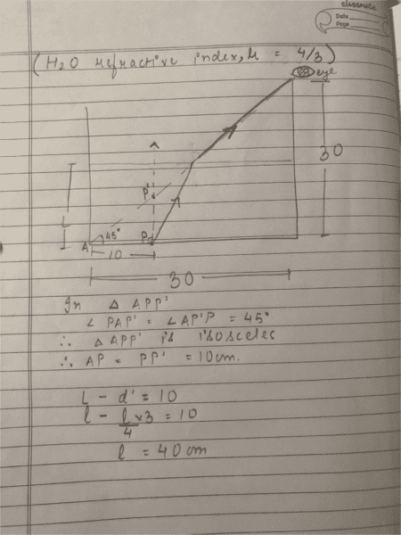

A cylindrical vessel whose diameter and height both are equal to 30 cm is placed on a horizontal surface and a small particle p is placed in it at a distance of 5 cm from the centre. An eye is placed at a position such that the edge of the bottom is in the plane of drawing. Upto what minimum height should water be filled in the vessel to make particle p visible?
Apparent depth (d’) = real depth (d) / refractive index
My answer is 40 cm which is wrong.
That formula is for looking straight down, i.e. the line of vision is normal to the surface,
Apply Snell's Law instead.

Rightwrong said:
But why do the rays bend if it’s for looking straight down?
Your pupil has diameter. Consider, from a point object, one ray to each side of the iris. These are not quite vertical, so as they emerge will be bent just a little away from each other. Project the emerging rays back down to the point where they intersect. This will be where the object appears to be.
The calculation of apparent depth assumes these angles are small. In the problem you are given the angles are much larger.

Draw a ray from the object that is a small angle θ above the horizontal. (You can draw it large for legibility but bear in mind that is in principle small.)
Show how it deviates at each interface before reaching the eye.
We can take the horizontal line as a second ray, not deviating.
Project back the final section of the first until it meets the horizontal one. That is where the object will appear to be.
Now use some geometry to relate the apparent distance to the other distances and the angles.
