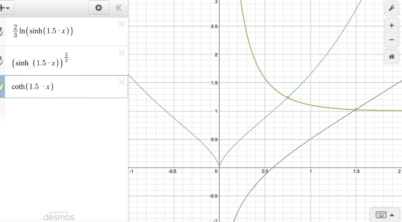

Here's an illustration of what I'm talking about. The cosmic scale function, call it a(t). This is the version that is not normalized to equal 1 at present (t = 0.8) so it equals slightly over 1.3 instead, but that does not matter for this. It's the blue curve.
And the LOG of the scale function--the red curve.
And the Hubble rate which is the SLOPE of the log of the scale function
You can see that at first the red curve (the log) rises very steeply, so the green curve (its slope) is high.
But then between 1 and 1.5 the red curve slope is almost down to a mere 1. You can read that off the graph. So the green curve which gives the slope settles down to near 1.
Between 1.5 and 2 the green curve is almost indistinguishable from constant 1, so the red curve has become virtually indistinguishable from a straight line with slope 1.
The green curve shows the real universe's actual Hubble rate (in zeit units). Just look where the green curve is at t=0.8.
You can check that at the present (t=0.8) it is 1.2 zeit-1 ---which is right, corresponds to recent measurements of the Hubble rate. Incidentally the same as (0.83 zeit)-1---0.83 zeit is the current value of the Hubble time and 0.83 lightzeit is the Hubble radius. Just have to take the reciprocal of 1.2.

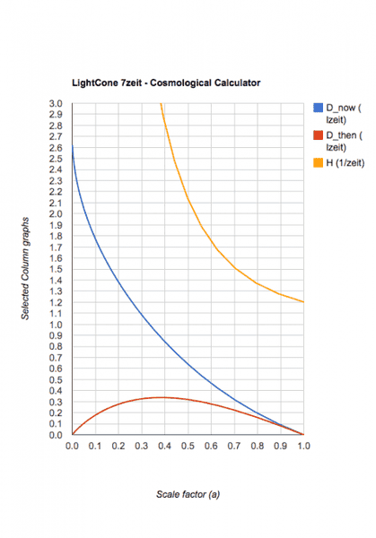

In the hypersine thread I was wondering how one could address a newcomer's questions such as how do we know 0.8 (the expansion age)? and how do we know 2.67 lightzeit (the observable range now---presentday particle horizon)?
It seems like a lot, perhaps most, basic cosmology observational data falls along the blue curve: scalefactor-distance curve.
Incoming light tells you its source scalefactor (relative size of distances back when the light was emitted).
And then there are various opportunities to determine the presentday distance to its source.
So based on reasonable assumptions like GR describes gravity one draws the blue curve and fits it to the data and right away it points to 2.67.
That seems fairly straightforward, although it's complicated down at the level of detail.
But how to explain that the expansion age is 0.8 zeit?
It could be that I'm asking how to make it intuitive that we can add a third curve (time) to the graph, just reaching 0.8 at the right edge where a = 1.0.
https://www.physicsforums.com/insights/approximate-lcdm-expansion-simplified-math-part-4/
Or maybe the third curve should not be time (as function of scalefactor) but H(a) the expansion speed-to-size ratio (again as a function of a)
To recap, distance to source, and scalefactor, are directly measured, that's the blue curve---which multiplying by scalefactor immediately give the red curve. So we can consider those two as observed. Now the question is what can we derive. Can we derive H(a) the yellow curve? For sure, cosmologists do that by fitting the Friedmann model to the data, but can we make the chain of inference intuitive?

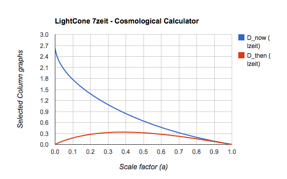

I think Fig. 2.2 (https://www.physicsforums.com/insights/approximate-lcdm-expansion-simplified-math-part-2/) is the best to show the 0.8 zeit present time.
But more curves can be added, as long as it does not interrupt the flow of the Insight posts too much. Perhaps it is better to just use additional curves in answers to questions?
