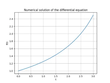

Say ##f(0)## and function form ##g(f(t),t)## are given, we may think of t evolution by continuing iteration,i.e.,
$$f(\triangle t) \approx f(0)+g(f(0),0) \triangle t
$$f(2\triangle t) \approx f(\triangle t)+g(f(\triangle t),\triangle t) \triangle t$$
$$f(3\triangle t) \approx f(2\triangle t) + g(f(2\triangle t),2\triangle t) \triangle t$$
$$f(N\triangle t) \approx f((N-1)\triangle t) + g(f((N-1)\triangle t),(N-1)\triangle t) \triangle t$$
A numerical solution chart by ChatGPT for ## c_0=c_1=c_2=c_4=1,\ c_3=5,\ c_5=4,\ c_6=0.5,\ f(0)=1 ##.
Line graph titled 'Numerical solution of the differential equation', plotting f(t) against t from 0 to 3, with f(t) rising from 1.0 at t=0 to about 2.5 at t=3 in a convex, accelerating curve.
Thanks a lot, but I'm actually interested in a closed form (approximate) solution.

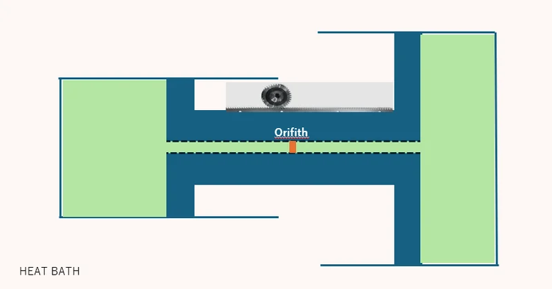

Thanks for your comment. Due to my PC operation trouble I deleted my previous post in fail. I am sorry about it.
Let me continue.
As equation of gas1 and gas2 mols, (13) is written as
$$RT \frac{d}{dt}n_1=\frac{d}{dt}(P_1V_1)=-2c_0\sqrt{(P_1-P_2)P_2}$$
loss of gas1 equals gain of gas2 so
$$RT \frac{d}{dt}n_2=\frac{d}{dt}(P_2V_2)= 2c_0\sqrt{(P_1-P_2)P_2}$$

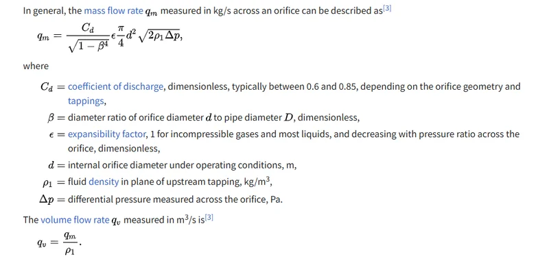

I do not like the last ##P_2## which breaks the symmetry. Say ##P_2=0##, side 2 is vaccum, F=0 so no gas transfer through oriffith. It contradicts the intuition. May I expect symmetric term like $$ c\sqrt{P_1-P_2} $$ instead , where only pressure difference matters ?
Ref. Wikipedia Orifice plate https://en.wikipedia.org/wiki/Orifice_plate#cite_note-ISO5167-1-3
Text with equations giving the mass flow rate q_m across an orifice as C_d over the square root of (1 - beta^4), times epsilon, times pi/4 times d squared, times the square root of 2 rho_1 Delta p, with definitions of each symbol and the volume flow rate q_v = q_m / rho_1.
That seems to support my idea.

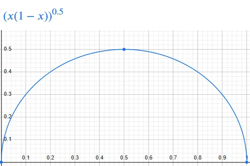

Finally, x(t) is just a "placeholder-function" that allows to write F(t) step by step, otherwise it would be too cumbersome to write it in its full formulation directly and explicitly. Please note that I told you half the story: actually, F(t)=1 when x(t)>0.5. And yes, F(t) is exactly a non-constant coefficient that describes the flow of gas through the orifice.
I do not find these features of F in neither ##\sqrt{(P_1-P_2)P_2}## nor ##\sqrt{P_1-P_2}##. Am I missing something ?
With no regard what function form F has, we can write
$$\frac{d}{dt}[P_1(V_{10}-A_1vt)]=-\epsilon F(P_1,P_2)$$
$$\frac{d}{dt}[P_2(V_{20}+A_2vt)]= \epsilon F(P_1,P_2)$$
We expect ##0<\epsilon <<1## because oriffith is small. If there is no oriffith, pressures are
$$P_1(t)=\frac{P_{10}V_{10}}{V_{10}-A_1vt}:=\hat{P}_1(t)$$
$$P_2(t)=\frac{P_{20}V_{20}}{V_{20}+A_2vt}:=\hat{P}_2(t)$$
We expect
$$F(P_1,P_2) \approx F(\hat{P}_1,\hat{P_2})$$
is a good approximation because orifith is small. In this approximation
$$P_1(t)=\hat{P}_1(t)-\frac{\epsilon}{V_{10}-A_1vt} \int_0^t F(\hat{P}_1,\hat{P}_2)dt $$
$$P_2(t)=\hat{P}_2(t)+\frac{\epsilon}{V_{20}+A_2vt} \int_0^t F(\hat{P}_1,\hat{P}_2)dt $$
If we input this P's solution into F, we will get better solution of order ##\epsilon^2## and so on.
Schematic of two gas-filled cylinders joined by a narrow orifice, with a piston and gear rack moving the left chamber, and the label HEAT BATH beneath.

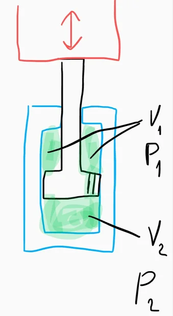

The sketch you've drawn would probably not work like the system I described. The real situation is:
Hand-drawn sketch of a piston in a cylinder: a red-outlined block with a double arrow above a rod entering a blue-outlined cylinder, with green shaded gas regions labelled V1 and P1 above the piston and V2 and P2 below it.
anuttarasammyak said:
We are sharing the situation. I do not find any essential difference in the drawings.
Yes, sorry, I replied too much in a hurry during lunch break. :smile: I'll think about your last post thank you
