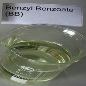

Hello dear! It is a simple concept.
The word "aqua" refers to water.So aqueous solution means a solution which has water as solvent.
Liquid solution means a solution which uses a liquid other than water as solvent.
Solvent is nothing other than a substance which is more in the solution or it is a phase in which we dissolve or add substance (solute).
Likes symbolipoint and navneet9431
In aqueous solution always water is the solvent
And in liquid solution Benzene ,ether and so on can taken as solvent.
(Pics source: Google)

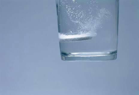

But “Dissolved” is e.g. what happens to ordinary salt salt when you mix it with water. You get a solution; It even looks like water but it is not pure water any more. You can boil the water off, and you recover the salt.
Also many gasses dissolve in water. The most familiar example is carbon dioxide – 1ML of this gas (which is not very much of the substance) dissolves in one ml of water,So most water around has this carbon dioxide dissolved in it. But you can make more carbon dioxide dissolve if you put it in contact with water at high pressure. That is what you have in fizzy drinks. When you open the sealed bottle and release pressure you see the bubbles of carbon dioxide come out. Hydrogen chloride which has been mentioned is much more soluble than that in water, and there are some dramatic demonstrations if you are lucky enough to be shown one in a school laboratory.
