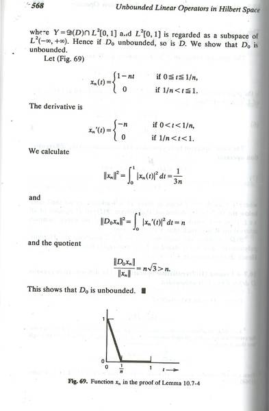

Hi Mathman, thanks for this.I made a typo there, the criterion for boundedness of an operator T should be:
\begin{equation}
\sqrt {\frac{||Tf(x)||}{||f(x)||}} < ||Tf(x)||
\end{equation}
http://www.fjordforsk.no/Unititled.jpg

Your revised definition is the same (wrong) as the original. All you did was replace the letter B by the letter T, but otherwise left the expression unchanged.

Mathman, As you can see from the attached image, it should be as given with the square root. I can't really find any other form, than the given one in the book, unless Kreyszig was wrong there ( in addition to the typo on the upper limit of the integral which should be 1/n thanks to some other guys answering on another thread).

This inequality is also the book. So why are there two inequalities for boundedness and is there a typo in the page-scan?
You don't show the scan of the book definition, but @mathman 's definition is correct. (see https://en.wikipedia.org/wiki/Bounded_operator ). The definitions that you are quoting do not make sense.

Is the scan non visible?
Please see again:
note a typo in the upper limit, 1 should be 1/n. except for this, the last part, the inequality seems correct.
Please see again:
It's perfectly readable. No equation on that page is the same as equation (2) of post #3. Nothing on that page is the definition of a bounded operator. The last equation is related to the definition only to show that the example is not bounded.
