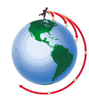

Generalizing: Every closed path that an object takes around another (or their mutual center of gravity) due to gravity alone is an ellipse. If you throw a baseball, you've created an elliptical orbit...albeit short-lived. So you really don't even have to try hard to make an orbit. All you need to do is throw something hard enough that it misses the Earth on the way back down, but not hard enough to escape. Then the ellipse just happens. But only one of the infinite number of ellipses you can create that way is also a circle.

russ_watters said:
...If you throw a baseball...
Orodruin said:
Just nitpicking, ...
Must include the magnus effect too. With a hook or slice it is not a circle or an ellipse because it is not in a plane. With backspin it could still be in a plane but not be a circle or ellipse. youtube
There is also a hyperbola. The set of all hyperbolic orbits passing through a point above a planet is larger than the set of elliptical orbits passing through that point.
Orodruin said:
Depends on how you define "hit the Earth". Either way, you would need to throw it tangentially for this to happen and the entire thing is either way not possible to due to air resistance etc.
Agreed! Nevertheless, it is a popular way to describe an orbit in the first pass. There's dozens of these online in k-12 course notes:
