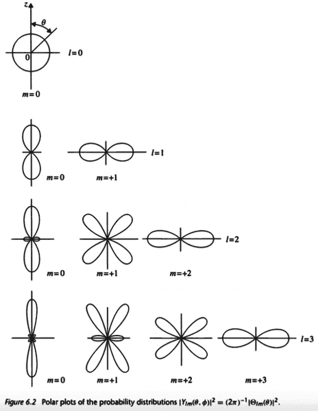

The probability distribution of the position of the electron of a hydrogen atom is related to the following polar plots
Suppose the electron is excited from the ##1s## orbital to the ##2p_x## orbital. Does it make sense to talk about the ##2p_x## orbital having a dumbbell shape pointing in the ##x## direction since the ##z## axis can be pointing in any direction? Shouldn't all orbitals be spherical when we consider there is an equal probability for the ##z## axis to point in any direction?
Happiness said:
Does it make sense to talk about the 2px2p_x orbital having a dumbbell shape pointing in the xx direction since the zz axis can be pointing in any direction?
What are shown in the picture above are actually the cross-section of ##|Y_{lm}(\theta,\phi)|^2## in the xz plane, so when viewed as a 3D distribution, the ##2p_x## orbital does not have a dumbbell shape.
Be careful that what you posted are pictures of the the spherical harmonics, which are complex functions, while ##p_x## is a real function, linear combination of spherical harmonics, and is not an eigenfunction of ##\hat{L}_z##.
No, you can have a polarized sample. At equilibrium, you should have on average an isotropic distribution, but one can prepare an atomic sample in a given ##l, m_l## state. Note that the preparation aspect is going to define a laboratory z axis: the choice of axes is no longer arbitrary.
