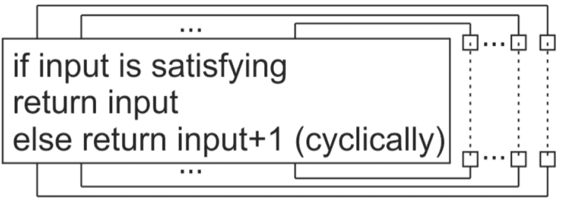

It seems the question concerns ways of using electrons in ways alternative to standard electronics (?) ... like quantum computers - for which there is still not known polynomial algorithm for NP.
Here is another alternative - NP complete problem (nondeterministic polynomial) can be transformed into search for a fixed point:
imagine a hardware implemented verifier for an instance of NP problem - which sends to own input the same if it solves the problem, "input+1" otherwise:
Such circuit with clock would test one possibility per cycle, finally reaching a satisfying input in exponential expected time.
But what if there is not clock?
We would get hydrodynamics of electrons, which fixed point solves our NP problem - could such electron flow stabilize faster than in exponential expected time?
