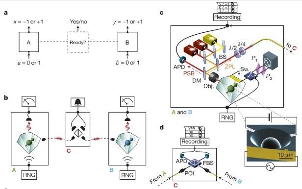

In the Loophole-free Bell inequality violation using electron spins separated by 1.3 kilometres experiment http://www.nature.com/nature/journal/v526/n7575/full/nature15759.html, all mismatched photons (when α = β) are not considered entangled and are not used. Consider their selection criteria in this image at D).
Diagram of a loophole-free Bell test: panel a shows measurement settings a and b with outcomes, panel b shows stations A, B and C with random number generators, panel c shows the optical setup with beam splitters and a photon detector, and panel d shows the entangled-photon detection arrangement at station C.
I think that sometimes people do misuse post-selection in their experiments, but I don't think of the Hensen et al. experiment as an example of that. They're picking out a subset of the games to keep, but the event that determines keep-vs-toss is spacelike separated from the "player" events. Strictly speaking it's not a CHSH game, but the changed game still has a Bell inequality to violate and they violated it.
The reason they expected to violate the inequality involved entanglement and post-selection, but the actual measured violations didn't depend on those assumptions. The classical limits on how often you can win don't depend on anything about entanglement and can't be perturbed by a spacelike separated choice to keep-or-toss.

I disagree. If two photons with with different polarization's arrived within the same timeslot, that event would not be used.
From the article:
If the photons are indistinguishable in all degrees of freedom, then the observation of one early and one late photon in different output ports projects the spins at A and B into the maximally entangled state
Equation for a maximally entangled spin state: |psi-> = (|↑↓> - |↓↑>)/√2.
, where ms = 0 ≡ |↑
and ms = −1 ≡ |↓
. These detections herald the successful preparation and play the role of the event-ready signal in Bell’s proposed set-up.

I meant I didn't think it was an example of misuse of post-selection. Obviously they do use post-selection.

It looks like they are assuming the polarization is the same since they are excluding all polarizations that are mismatches (no matter how caused) from the experiment.

This is in the swapping part of the unit. This prepares the desired state. They can include or exclude whatever they like in determining event ready pairs elsewhere. (I.e. these are determined outside the relevant time cone.) They could pick them by hand as long as that decision is independent of the results elsewhere.

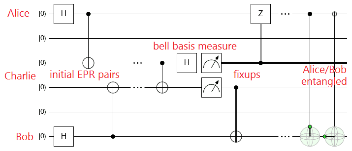

Note that entanglement swapping doesn't require post-selection. It can be done with fixup operations instead. In effect, entanglement swapping is just quantum teleportation of an EPR half. It's just easier to do the fixing when analyzing the results rather than as a step in the experiment.
(One of my pet peeves is quantum teleportation experiments that use post-selection instead of fixup operations. No one would trust their qubits to a teleportation process that failed 75% of the time! It's like... instead of proving they could move the information reliably, they proved that if they had done the fixup operations then they could have moved the information reliably. )

An entanglement swap is just a quantum teleportation of an EPR half. So basically you just do the fixup operations you'd do in a quantum teleportation. Here's the circuit:
Quantum circuit diagram for entanglement swapping with Alice, Charlie and Bob on separate wires: initial EPR pairs, Bell basis measurement with H gate and meters, classically controlled Z and X fixups, ending with Alice/Bob entangled.
When Charlie gets a "bad" measurement result, it just means the X or Z parity of the entanglement is backwards, and he fixes it by telling Alice or Bob to flip their qubit over correspondingly. You can very freely split the fixup operations between them. Both fixup operations can go to Alice, or both to Bob, or one to each, or even combinations where one rotates by R and the other by 180-R.

Thanks!
As you have so generously explained with your diagram, it makes perfect sense. Never thought of it like that.
