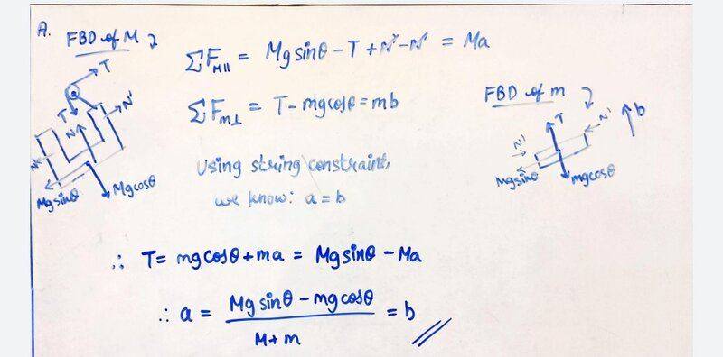

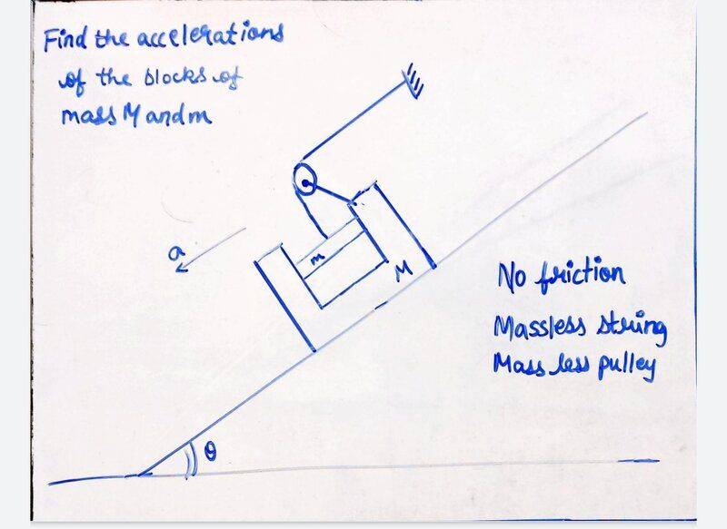

There is no friction, and the pulley is massless. What is the acceleration of mass M?
F = ma
Is my answer correct? And if not, why?

That I cannot tell you until I understand the setup shown in your drawing, specifically the disembodied piece of wall (upper right) to which the end of the string is attached. You show it just hanging in mid air which doesn't make much sense.
Differentiate it said:
So where did I go wrong?
It's just a fixed wall perpendicular to the incline. Also, would this be the correct answer? I don't really think so, but I'm just confirming

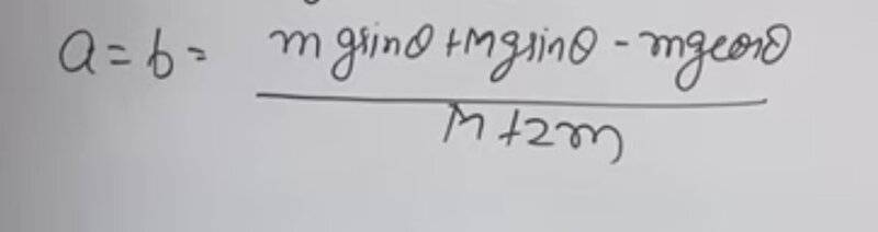

I've arrived at the second solution you've posted (which doesn't show any work). Given my track record, I estimate it gives it about a 10% chance of being correct :woot:.
How did you get to the second solution?
The funny thing is I think you could arrive at it, even with what I believe to be a false assumption that the Normal forces acting on the upper and lower portion of the blocks (where they contact each other) are equal in magnitude, but if you subbed that result back into any EoM in the ##x## direction you should get some kind of a contradiction.

Yes, you're right. I wasn't sure about the wall.

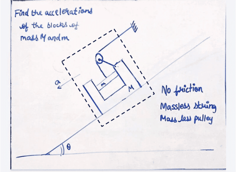

What do ##a## and ##b## represent? Are they supposed to be the accelerations of ##m## and ##M##? Please don't show just the bottom line of whatever work you did. How can we figure out where you went wrong if we don't know how you got there?
That said, consider taking the two masses together plus the pulley as your system. That would be all that is contained within the box with dotted lines in the picture. The external forces acting on this system are (a) Gravity ##(m+M)g##; (b) Normal force ##N##; (c) tension ##T##.
In the direction parallel to the incline you have
##T-(M+m)g\sin\!\theta=-(M+m)a.##
In the direction perpendicular to the incline you have
##N-(M+m)g\cos\!\theta=0.##
My point is that if you draw separate FBDs for ##M## and ##m##, the pairs of equations that you get should give the above two when added because the net force on ##m## plus the net force on ##M## is the net force on ##M+m##.

I don't think you handled the normal force ##N'## correctly.
You have ##N'## acting simultaneously down the slope and up the slope on ##M##. It's either one or the other, but not both. You can assume either one and then if you get a negative answer for ##N'## it means that ##N'## is acting in the opposite direction from your initial choice.
So, in your equation
, ##N'## doesn't cancel.
You'll need an additional equation. What about an equation for ##\sum F_{m, ||}## for the piston?

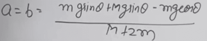

This looks correct to me.

Since the correct answer has been arrived at by OP, here is the Lagrange approach:
Distance of ##M## from top ##x##. The distance of ##m## from top along the incline is also ##x##. The perpendicular distance of ##m## from ramp is ##\ell + x##.
Potential energy is
V = -(m+M)g x \sin\theta + mg (\ell + x)\cos\theta.
Kinetic energy is
T = \frac{M}2 \dot x^2 + m\dot x^2.
Equations of motion directly follow
\frac{d}{dt}(\partial_{\dot x} T) =(M + 2m)\ddot x = -\partial_x V = (m+M)g\sin\theta + mg\cos\theta
or equivalently
a = \frac{ (m+M)g\sin\theta - mg\cos\theta}{M + 2m}

How did you get this equation? Also , I think N' + mgsinθ = ma is incorrect.
I think it is T - mgcosθ = mb. I'm sorry for not mentioning, but a is the acceleration of M with respect to the ground and b is the acceleration of m with respect to M.
Please look into my solution again and tell me where I went wrong. The second image is the correct answer. If I forgot to mention,
•a is the acceleration of M with respect to the ground
•b is the acceleration of m with respect to M.
•I also know that a = b
And that's how I got my answer. Is there something wrong in my FBD's? Or is it something else?

You shouldn't assume (as you have) the normal forces are equal in magnitude. You don't know that. Assuming an interference fit, it would be a very specific acceleration that would have ## |N_l| = |N_u|##. Technically we don't even know if there are two normal forces acting between the masses, in practice it would depend on the fit between the bodies.
## N_l ## is the normal force acting on the lower sided of the masses and ##N_u## the upper side.
If the fit is loose, then at the very least you must have 1 normal force ( whether or not the hanging mass is sliding up the upper of lower side. Your first attempt has no net normal forces whatsoever.

It fits in perfectly, so, in that case, the normal forces are the same, right?
No, gravity would pull it to the lower side ( if the system was static ), and it would have a single Normal.
If it were a squeezed fit ( force fit ) it would have two Normals. However, they would not be equal in general for two reasons in this problem...gravity, and acceleration.
erobz said:
no, gravity would pull it to the lower side.
I believe in my equation
Mgsinθ - T +N' - N'
I have taken gravity into account
