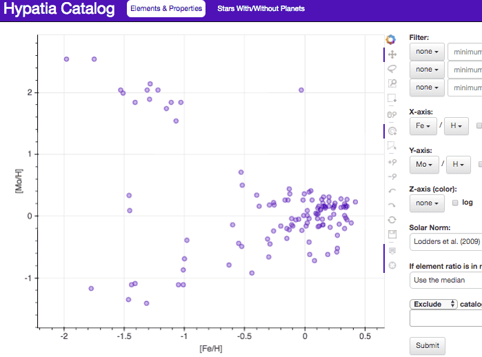

After an hour of googling, I came across an interesting web site: http://www.nataliehinkel.com/hypatia-catalog.html
The Catalog
The full database can be accessed at www.hypatiacatalog.com.
I study the element abundances in the solar neighborhood, or within 150pc of the Sun. I have put together the largest collection of stellar abundances, called the Hypatia Catalog, for 53 elements within +4,300 main sequence (FGK-type) stars as compiled from literature. Hypatia provides a wealth of chemical abundances and kinematic information which has implications for the evolution of our nearby galaxy, the formation of planetary systems, and astrobiology.
Natalie appears to have put together a tool which might answer your question(s).
I say "appears" and "might", as I'm not an astrophysicist, and don't understand negative ratios.
Scatter plot from the Hypatia Catalog of [Mo/H] against [Fe/H] for stars, with most points clustered between -0.5 and 0.5 on the x-axis and near 0 on the y-axis, and a sparser spread of points at lower and higher values.
