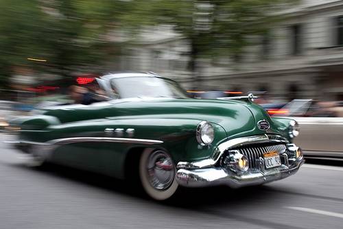

What ISO to use depends on a few factors:
- how much light is there? Very little light (like Andre's Blacksmith): High ISO. A lot of light (bright daylight outdoors): Low ISO
- Focal length: Tele is much more sensitive to camera shake (even with stabilizers) and therefore needs shorter exposure times. As a rule of thumb, the exposure time should not be longer than 1/(focal length), so for a 300mm tele, set the ISO such that the exposure time is 1/250 sec or faster.
Note that at the tele end of your zoom you are generally limited to quite small apertures (like f/5.6 or f/8). That does not leave a lot of margin for playing with aperture vs. exposure time.
- Subject movement: For moving subjects you often want to "freeze" the action. That means short exposure times. But then again sometimes you want the opposite. Take a shot, look at what you've got and change exposure time and ISO as needed.
1952 Buick Eight by carsten de, on Flickr
(Canon EOS 5D Mk2, ISO 400, f=28mm, 1/10 sec at f/5.6. This was taken at 8pm with fairly low light)

By the way, M. Quack, regarding the photo of the car: I don't understand how it's possible that the back of the car seem to have moved during the exposure time of the camera while the front part has not.
I'd understand if the back of the car was out of focus while the front was right on the focus, but it doesn't look like it. It looks like the back is not only blurry but also "moving" (same for the head of the passenger). How is that possible?
Interesting question, I am not quite sure myself. It must be related to the wide angle. I was focusing at the front of the car and panning along. The car was maybe 3m away. The panning motion was a rotation, so effectively the car was rotated about the focus spot, too, by the same angle. If you are panning with a tele lens, then the angle will be much smaller, so the effect might not show up as much.
This is not some freak accident, there are a couple of other pics that show the same effect.
Probably so, I wondered the same but as the car got closer it must have 'grown' backwards. I wonder how a sequence of 6 fps would have shown, but at 1/10 shutter speed, that rate is probably not obtainable.
I would guess that it's due mainly to focus being locked only on the front of the car. Look how blurry the car by the left headlamp is. My camera has a defocus mode and can take similar pictures on purpose:
Hmm Maui, I don't see the similarity between your photo and M quack's.
I've been thinking about http://en.wikipedia.org/wiki/Rolling_shutter, rolling shutter. Namely the left side of the photo is scanned before the right side. If we add the focus on the front part of the car, I think it makes sense.
I don't think AF tracking is the culprit.
Assuming that the car moved at 10 km/h, it moved by ~30cm during the 1/10sec exposure time. A DOF calculator (http://www.dofmaster.com/dofjs.html) gives sharpness from 2.15m to 28.5m for 28mm at f/5.6 with focus at 4m. This easily covers the entire car, moving or not.
I don't think that this is a rolling shutter effect either. For that the exposure time is much too long. Also, remember that this is a DSLR with a real, mechanical shutter.
That leave the panning motion.
Draw the car as a box, say 2x4m, and the photographer as a point, say 2m ahead and 2m sideways. Draw a line from the point closest to the photographer, and a line from the rear of the car to the photographer.
Now displace the car forward a bit and redraw the lines. The angle between the two front lines is much larger than that between the two rear lines.
So by tracking the front of the car (rotating by the angle between the two front lines), the rear gets smeared out (by the difference in angle).
[itex] \tan \alpha(t) = \frac{d_{\parallel}+vt}{d_{\perp}}\\<br /> \frac{\mathrm{d}\alpha(t)}{\mathrm{d}t} = \frac{1}{1+(\frac{d_\parallel+vt}{d_{\perp}})^2} \cdot \frac{v}{d_\perp}[/itex]
For the front, [itex]d_\parallel=2\mathrm{m}[/itex]. For the rear [itex]d_\parallel=6\mathrm{m}[/itex], so the sweep rate is much larger for the front (v/4m) than for the rear (v/20m). Parallel and perpendicular refer to the motion of the car.
The effect is so noticable because the length of the car is quite large compared to the distance to the photographer.
I think you got it here M Quack, that makes sense.
Also putting panning motion in google picture shows similar pictures. There's even a photo where the moving object's closest to the camera point is in its middle. So both the rear and front looks like "they are moving". (http://www.dailytravelphotos.com/archive/2009/12/01/)
I don't think it depends on which point of the object is closest to the camera.
What is important is that different points have different distances. I could have tried to track the rear of the car, then the front would have been smeared (in the opposite direction). Have to try this one day...
