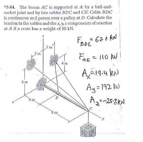

Tensions in physics problems are represented as unit vectors to accurately depict their direction and magnitude. In the context of the cable BDC, the tension in segments BD and DC is uniform due to the continuous nature of the cable and the presence of a pulley at point D. To solve these problems, it is essential to resolve tensions into their i, j, and k components, ensuring that forces act along the length of the strings. This method clarifies the relationship between the forces and their respective directions.
