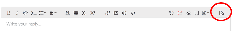

Brian_D said:
P.S. I tried to preview the homework statement and relevant equations, but didn't see how to do it.
Thank you, but the preview button only seems to work for text in the text box, not for the homework statement and relevant equations boxes. I didn't see a preview option for the latter two boxes.
P.S. The answer that the textbook gives for this problem is 585 m/s
Sorry, my mistake. You're right, I see no way to preview LaTeX in the title, problem statement or relevant equations. But you can edit your post:
"##V=\sqrt{F/\mu}##; where ##V## is wave velocity, ##F## is tension force on wire, ##\mu## is mass per unit length of wire"
Yes, and the solution is straightforward (it just occurred to me). We can preview the problem statement and the relevant equations simply by putting them into the text box, then copy and paste them into the other boxes.
