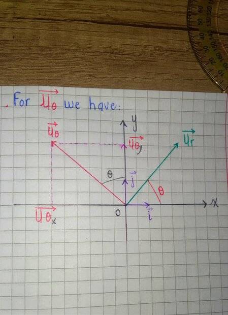

What is the significance of the negative sign [-] before [sin] in the final expression for Uθ? or was it just my mistake in the projections that prevented me from finding it?
Angular Unit Vector.
"Firstly, I represented []on the two-dimensional polar coordinate system to facilitate the steps and projections."
Then, I have written the steps, step by step, to ultimately derive the expression U(θ) in terms of i and j which is:
[ Uθ=−sin(θ)i+cos(θ)j ]
NOTE:
The professor provided us with this expression directly, without proof, for that reason, I am aware of it. And I just wanted to substantiate it myself as an attempt."
Here are the steps:
``However, as I mentioned earlier, I did not ascertain the origin of the negative sign before sin [Uθ=−sin(θ)i] in the end . Does it merely indicate the opposite direction for the unit vector i ? (meaning it is only written as an indication in the end)? Or have I made an error in the projection concerning the angles or something like that??

Your diagram seems to define ##\theta## in 2 different ways, one with respect to the x-axis and the other with respect to the y-axis. You can't do that!

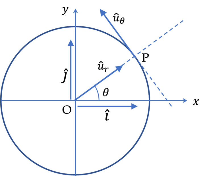

Maybe this diagram makes it clearer:
(diagram taken from here: http://www.physicsbootcamp.org/Motion-in-Polar-Coordinates.html )
On the diagram, the angular unit-vector, ##\hat u_{\theta}## is directed at angle ##\frac {\pi}2 + \theta## (angle measured counter-clockwise from the +x-axis). So that's the angle you must use when finding ##\hat u_{\theta}##'s components.

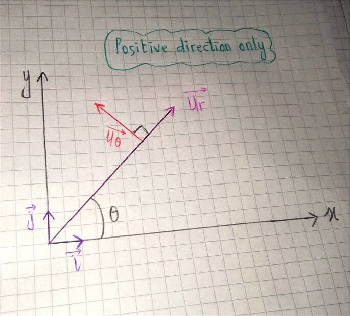

In addition, I know that Uθ=Ur( θ=θ+2/π) which means that we obtain it by rotating Ur by an angle of π/2 in the direction of the angular rotation θ. but i'm not pretty sure if that means that: if for example is pointing in the positive x and y direction then the final expression is gonna be Uθ=sin(θ)i+cos(θ)j . In other words, that negative sign signifies only the direction of the and it is not to be directly memorized as it was!!
@Steve4Physics :
In the illustration, the direction of Uθ doesn't matter; what's important is that it is perpendicular to Ur. which means that i can draw it like the diagram you provided or simply just like I did.
For that reason i was asking about the minus sign in the expression Uθ=−sin(θ)i if it is an indication about the direction only or a part of a general law.

That's what i meant it Mr.
When drawing both polar unit vectors in the x and y positive direction. The final expression of the relationship between (Ur , Uθ, i and j) is it gonna be Uθ=sin(θ)i+cos(θ)j ! Or still Uθ=-sin(θ)i+cos(θ)j (with minus sign)
Agreed. But I provided a different drawing because (as stated) I thought your drawing made ##\theta## ambiguous. Maybe I was being too fussy.

The minus sign follows from basic trig’. It’s worth understanding where it comes from and being able to derive it for yourself. Here’s one way.
If ##\hat u_r## points in direction ##\theta## then ##\hat u_{\theta}## points in direction ##\alpha = \frac {\pi}2 + \theta##.
The projection of ##\hat u_{\theta}## (length =1) onto the x-axis is
## 1*\cos \alpha = \cos (\frac {\pi}2 + \theta)##
We use the identity ##\cos (\frac {\pi}2 + \theta) \equiv -\sin \theta##. That's where the minus sign creeps in.
So the projection of ##\hat u_{\theta}## onto to the x-axis is ##-\sin(\theta)##. I.e the x-part of ##\hat u_{\theta}## is ##-\sin(\theta) \hat i##
