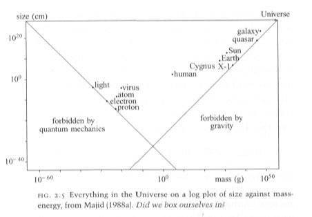

The following graph (after Majid) might be interesting.

Interesting graph.
I wonder what lies in the line intercept?
