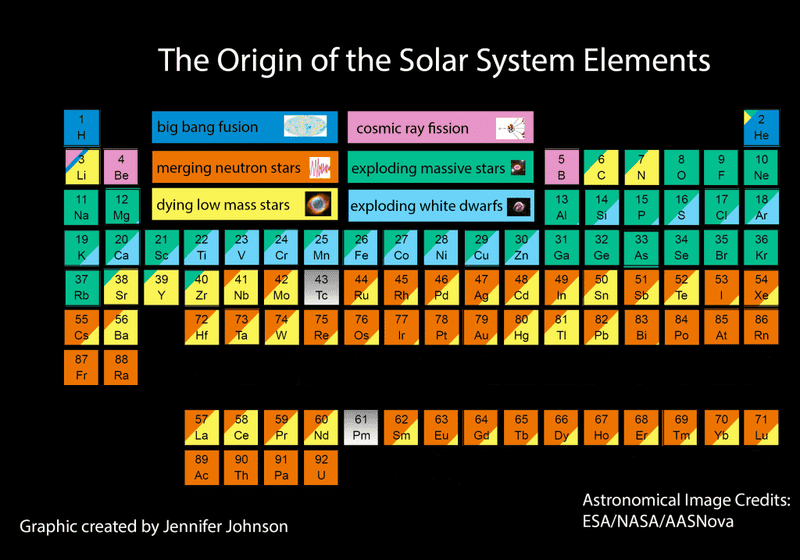

Supernova explosions can also generate heavier elements, including gold. I'm sure there are papers on the subject, including the % of elements made.
It is now thought that the heaviest elements, including gold and uranium, are not created in supernovae. Per the diagram below, core collapse supernovae ("exploding massive stars" in the diagram) don't contribute much beyond rubidium (atomic mass = 37), with type 1A supernovae ("exploding white dwarfs") contributing most of the elements around iron (atomic mass = 26). Beyond rubidium, it's asymptotic red giant branch stars ("dying low mass stars") and merging binary neutron stars that are the biggest contributors.
Source: Origin of the Elements in the Solar System, Jennifer Johnson

Relevant to this thread, how heavier elements may have gotten around the universe:
Space.com article cites this article saying that heavier elements (oxygen and carbon) from supernovas etc. get blown out of galaxies and float around (as circum-galactic medium) before re-entering a galaxy later (billions of years are involved here).
I’m quite surprised by how complex these origins are, tbh. The elements spread throughout the universe due to processes like supernova explosions and stellar nucleosynthesis, not just neutron star collisions. Elements formed in earlier stars were dispersed into space during their life cycles, leading to their abundance on Earth. It’s a bit of a cosmic lottery, haha, but the universe has many processes that create and distribute elements over time.
Did you catch the mechanism whereby metals circulate from disc into circumgalactic crown?
Force from explosions, quasar blasting, and interstellar "winds"?
The thing is that the mechanisms differ in their force.
Supernovae of Type I and II propel large amounts of gas at high speeds, which might plough through appreciable amount of interstellar gas by inertia.
Mirids, in contrast, where the s process takes place, end up forming planetary nebulae - whose expansion is far slower than that of supernova nebula. Once the planetary nebula expansion is stopped by the ambient gas, how efficiently are s-process elements distributed? Or are they stuck in the local section of the disc gas? They certainly don´t have the inertia to escape a galaxy even if there were no interstellar gas to slow them down.
And kilonovae? They are dim compared to supernovae. What do kilonova nebulae look like? How long does it take for ambient gas to stop kilonova nebula expansion?
