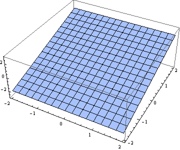

I'm pretty sure that's not the general solution but rather only a "special solution" which means we can't find the general solution but can find an expression representing a particular class of solutions. Often in non-linear equations, the general solution can't or is not easily found.
If this helps, I plugged the given solution into mathematica
[tex]{z}{=}{ax}{+}\sqrt{1-a^2}{y}{+}{B}[/tex]
letting B = 0, while a changes from 0 to 1.
Would there be any solutions for the equation that aren't planar?
You may consider infinitesimal portions of several moving surfaces["a" changing at different adjustable rates from zero to one or in some different way--say from one to zero] at different instants of time and sew them into a new surface which is not a plane.Each infinitesimal portion should satisfy the differential equation.
[Guest audience will get the picture of a moving surface in the attachment of the last post]
Okay; what I am picturing now is a ball rolling around on the flat surface above as it shifts back and forth. At any given instant, the ball is rolling on a flat surface.
More generally, just have a flat screen with an animation of a moving dot. Then shift the flat surface back and forth as the dot moves around the screen, (and raise it or lowering by changing your parameter B so that you are always rotating the surface around a fulcrum at the location of the dot) keeping track of the motion of the dot in three dimensional space.
So then you can look at the path of the dot in three dimensional space and ask yourself if the path actually satisfies the original differential equation. I would say definitely not.
So you lower your criteria and ask whether each "infinitesimal portion" of the path satisfies the differential equation. To which I have to ask, what do you mean by infiniitesimal?
Do you mean (1) very very small? If you do, all I need to do is jerk the platform fast enough that the differential equation is not satisfied in your very very small infinitesimal portion.
Or perhaps infinitesimal just means (2) "small enough an interval that the jerking of the platform will be almost unnoticeable."
Or a third possibility of what you mean by infinitesimal, is to (3) treat the infinitesimal as a hyper-real number (see http://en.wikipedia.org/wiki/Non-standard_analysis" .) Once we go down to this level, perhaps we could say the jerking of the platform would be entirely gone. But I disagree with doing it this way; once we get into hyper-real numbers and "true infinitesimal paths", I don't think we're dealing with the differential equation. We're just committing a division-by-zero error on the left-hand-side, and making a meaningless claim about linearity on the right-hand-side.
I think the best you can do is use definition (2), but with that word "almost" in there, you're not really satisfying the differential equation with a curved path. You're almost satisfying the differential equation because a the curved path is almost straight, over a small enough interval.

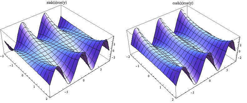

What if we get rid of the summation though and just try
[tex]\begin{matrix} z=e^{i k x} e^{k y}\\ \left (\frac{\partial z}{\partial x} \right )^2 = -k^2 z\\ \left (\frac{\partial z}{\partial y} \right )^2 = +k^2 z\\ \left (\frac{\partial z}{\partial x} \right )^2 + \left (\frac{\partial z}{\partial y} \right )^2=0 \end{matrix}[/tex]
I think it would work if you just use any individual wave-number. The summation would give difficulty though.
Just for fun, I plotted a couple of the homogeneous solutions.
They are pretty.

JDoolin said:
Yep, I goofed. I gave the solution to
[tex]\frac{\partial^2 z}{\partial x^2} + \frac{\partial ^2 z}{\partial y^2}= 0[/tex]
rather than
[tex]\left (\frac{\partial z}{\partial x} \right )^2 + \left (\frac{\partial z}{\partial y} \right )^2= 0[/tex]
[tex]z(x,y)=\sum_{n}e^{nx/ \lambda}e^{i n y / \lambda}[/tex] is definitely a solution to the homogeneous part of the first order ,non-linear PDE
