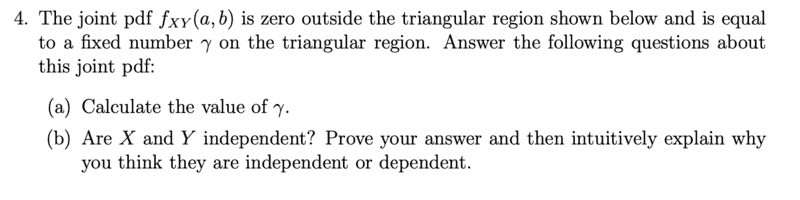

Are X and Y dependent random variables?
The discussion centers on the dependency of random variables X and Y. It is established that E(Y|X=0)=1/2 and E(Y|X=1)=0, indicating that Y is dependent on X. However, the probability density functions f_X suggest that X is independent of Y, as f_X=1-x for x>0 and f_X=1+x for x<0. This contradiction highlights the complexity of determining dependency in random variables.

(a) the agrea of the triangleses is 1, so γ one.
(b) I'm not sure how to prove. i feel like ##X## and ##Y## are dependent because ##E(Y|X=0)=\frac{1}{2}## and ##E(Y|X=1)=0## so ##Y## seems dependent on ##X##. ##f_X=1-x## for ##x>0## ane ##f_X=1+x## for ##x<0## so X seems independent on Y.
