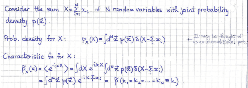

Handwritten derivation on grid paper: the sum X of N random variables with joint density p(x), its probability density P_X(X) as an integral with a delta function, and the characteristic function reduced to p-hat evaluated at k1 = k2 = ... = kN = k.
I am trying to understand the very last equality for (let me replace the tilda with a hat ) ##\hat{P_{X}(K)}=\hat{P(k_1=k_2=...=k_{N}=k)}##(1)

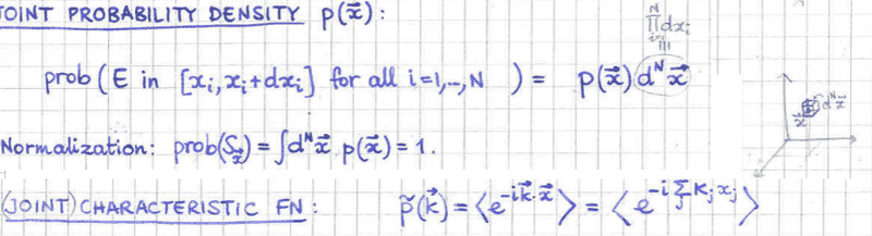

Handwritten notes defining the joint probability density p(x), the normalization of the density, and the joint characteristic function p-hat(k) as an average of exp(-i k.x).

Without independence instead i have:
##\int d^{N} \vec{x} p(\vec{x}) \exp^{-i k \sum\limits_j x_j } ##
and I can't see how you can make any conclusions without knowing what ## p(\vec{x}) ## is?

Looking again at your problem statement, I can see that you are trying to do something with random variables that are not independent, but you never state the question that you want to answer. You say you can't draw any conclusions about ##p(\vec{x})##. What kind of conclusions do you want to draw?
see bottom of my OP under section 1. I am trying to understand the last equailty...?

If ##\tilde{P}_X(k_1, k_2, \ldots, k_n)= \tilde{P}_X(\mathbf{k})## is the (multivariate) characteristic function of the multivariate density ##p(x_1, x_2, \ldots, x_n) = p(\mathbf{x})##, then, by definition we have
$$\tilde{P}_X(\mathbf{k}) = \int \exp(-i \: \mathbf{k \cdot x})\, p(\mathbf{x}) \, d^n \mathbf{x} $$
Also, by definition, if ##f_Y(y)## is the density function of the random variable ##Y = X_1 + X_2 + \cdots + X_n##, its characteristic function is
$$\tilde{P}_Y(k) = \int \exp(-i \, k y) f_Y(y) \, dy.$$
However, because of the Law of the Unconscious Statistician (LOTUS), we can write
$$\tilde{P}_Y(k) = \int \exp(-i k \sum_j x_j)\, p(\mathbf{x}) \, d^n \mathbf{x} \hspace{3em} (1) $$
(Note that in principle, we cannot simply write this down; we need to justify it. That is where the LOTUS comes in.)
Once we have equation (1) we can simply say that
$$\tilde{P}_Y(k) = \tilde{P}_X(k,k,k,\ldots,k).$$
That is probably what the author meant by his/her ill-advised notation.

Thanks! I think you meant ##\tilde{P}_Y(k) = \tilde{P}_X(k,k,k,\ldots,k)##, and you have given a good answer to the question in the OP about what that equality means.
