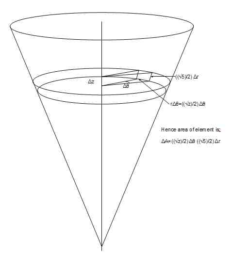

I've hit a roadblock on a question regarding Surface Integrals. I seem to be having a problem conceptualizing many of these concepts. Anyway, here goes.
Find the area of the following surface using an explicit description of a surface.
The cone \(z^2 = 4x^2 + 4y^2\) for \(0\leq z\leq4\)
I have solved for z and found the dS portion to = \(\sqrt{5}\) dA. This jives with the answer sheet that I have. It's the rest that I seem to be having troubles with.
Since it's a cone, shouldn't I just integrate like so?
\(\sqrt{5}\int_0^{2\pi}\int_0^4 (1)dz rdr \mbox{ for a final answer of }8\pi^2\sqrt5 \mbox{? The solution manual is showing an answer of }4\sqrt5\).
Any assistance, or a point in the right direction, will be greatly appreciated.
Thanks,
Mac

First observe that you have a cone with slant height \(2 \sqrt{5}\) and base radius \(2\), so the curved surface area is the circumference of the base (\(4 \pi\)) times the slant heigh over two = \(4 \pi \sqrt{5}\).
Now let's do this using integration. First switch to cylindrical polars, then the surface element is \((z/2)\;d\theta\; (\sqrt{5}/2) dz\), so the area is:
\[A=\int_{z=0}^4 \int_{\theta=0}^{2\pi} \frac{\sqrt{5}}{2} \frac{z}{2} d\theta dz\]
etc...
(you should always draw a picture for these problems if you can)

You draw a picture of the surface element at a point on the surface where angle subtended by the element is \(\Delta \theta\) and height is \(\Delta z\) and calculate its area for small \(\Delta\)s (so they are replaced by \(d\theta\) and \(dz\) )

The area of a surface patch is \(r\;d\theta dl\) where \(dl\) is the distance in the surface between \(z\) and \(z+dz\) and you replace \(r\) by its equivalent in terms of \(z\).
As I have said repeatedly draw a picture showing the area element on the surface between \(\theta\) and \(\theta+\Delta \theta\) and \(z\) and \(z+\Delta z\) and claculate its area.

Actually, I did draw a picture, still didn't help.
Thanks anyway.
Mac

Just a quick observation,
\(A=\int_{z=0}^4 \int_{\theta=0}^{2\pi} \frac{\sqrt{5}}{2} z d\theta dz \neq 4 \pi \sqrt{5}\)
\int_0^{2\pi}d\theta = 2\pi\Rightarrow\int_0^4\pi\sqrt{5}zdz = \frac{\pi\sqrt{5}}{2}\left.z^2\right|_0^4 = \frac{16\pi\sqrt{5}}{2} = 8\pi\sqrt{5}
Are you missing a factor of 1/2 with the Jacobian or something?
In post 2, it shows two factors of 1/2 which would be 1/4. Making that correction, we would have the desired results.

So I think the integral should have been expressed as
\int_{0}^4 \int_{0}^{2\pi} \frac{\sqrt{5}}{4} z d\theta dz$$
I have solved the integral the following way.
$$\int_0^{2\pi}\int_0^2 (\sqrt{5})rdrd\theta = 4\pi\sqrt{5}$$
Thanks everyone for their contributions.

There is a typo that is obvious if you look at the previous line, that is supposed to be the integral of the area element which has an extra 1/2 in it that has got lost.
Anyway it is fixed now.
